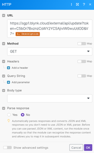

  3. Add HTTP request. We wanted to send the temperature that the elderly know if it's hot or cold
  4. Add HTTP request. We wanted to send the description of the weather today
  5. Add HTTP request. We wanted to send if it's rainy right now that the elderly will bring an umbrella with him

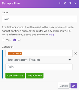

  6. Add a filter to see if the status is rainy today

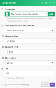

  2. Add a router

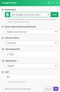

  3. Connect the router to the google sheet that contains the list of the times to take the pills.
  4. Initialize it to the relevant cell that matches a specific time to take the pills.

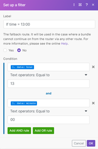

  5. Add a filter to the google sheet. Depending on the hour and the minutes, get the number of pills from the google sheets.

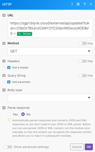

  6. Send an HTTP request with the relevant value (number of pills) to Blynk application.
  7. The request contains the token of the blynk and the number of the relevant port you want to present the data and the match value.

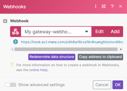

  1. Add a custom webhook.

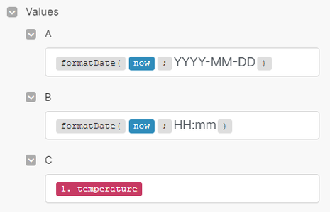

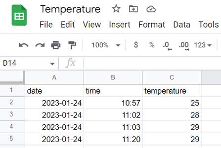

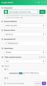

  3. Add google sheet to add a new row every time the temperature in the house is over a configured threshold in the attach arduino (.ino) code.
