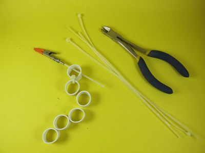

First, I found a broken umbrella and cut the fiber rod, I attach a clamp on the terminal size and wrap it with heat-shrink tubing (prevent electrostatic).
Then, I get some PVC tubing left from my previous project and cut it into small rings.
Get one piece of the PVC ring and drill 2 holes, insert the umbrella rod into it, since the hole are not line up in a straight line and the rod provide some flexibility, the friction can hole the rod and allow u to adjust the length freely.
Use nylon zip ties to tie up 5 PVC rings and cut the excess length.
Drill a hole on the bottom ring.
