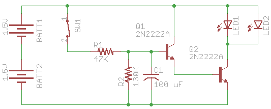

Step 4: Build the Electonics
My initial approach was to use a microcontroller. I made one of the various AVR programmers that plugs into a printer port and started work with an ATTiny85. In the end though, although I learned a lot about programming AVRs, this was just too dang complicated. So I simplified it and just used a couple of transistors, resistors, and a capacitor to get a glow-on and fade-off effect.
The schematic for what I came up with is attached. The fade effect is achieved with a simple R-C circuit. When the switch is closed, current flows through the 47K resistor to charge the capacitor. As the capacitor charges, the increasing voltage causes the transistors to ramp on, which pulls more and more current through the LEDs until they reach full brightness. When the switch is opened, the 130K resistor bleeds the capacitor down, gradually shutting off the current through the transistors and the LEDs appear to fade.
This circuit took quite a bit of tweaking to get the effect I wanted, so plan on playing around with the resistor and cap values until you get the effect you want. In order to get enough power through a transistor to really light up the LEDs, I chained two 2N2222As so that the first one can eventually saturate the base of the second one and really drive the LEDs to full brightness. Your results will depend upon the LEDs you use. I used amber ones. Remember that green and blue LEDs require a higher voltage to get full brightness, so you'll need to make adjustments if you use a different color.
As far as the physical shape, the idea here is that the circuit you will build must slide easily, but snugly, into the pipe from the top. The battery holders should have enough friction to hold the whole assembly in place. You can also coil some of the wire so that it's snug to the inside of the pipe. The battery holders should be at the bottom, then the magnetic reed switch, then at the top the resistors, cap, and transistors. The LEDs should be pointing upward from the top.
Here's the secret behind this whole thing: when you hold the staff, you will have the magnet(s) taped to one of your fingers. That finger will rest against the PVC over the magnetic switch, activating it. That's why you will be the only one who can activate the staff. When you build the electronics, make the wire long enough that it positions the magnetic switch right where you will hold it. When I built mine, I made it so that the switch was about 1/3 the way down from the top of the staff.
The picture shows about what it should look like. Make sure you test it before moving on to the next step!
