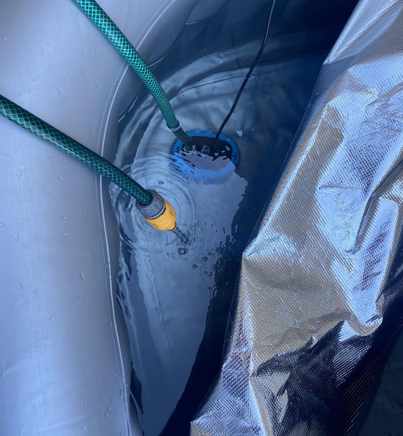

Step 7: Filling Up
We filled up the water and tested the filtration and lighting and put our survivors back!
