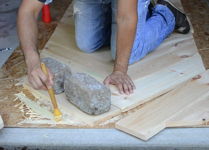

Step 6: Gluing Top
Before I glued the boards up, I dried fit them to make sure all the pieces fit well and to expedite the gluing process….but…..I guess I either lost a piece from the corner or maybe even used it somewhere else. Thankfully I did have an extra piece that did fit there, but that would also need trimming before adding the edge trim.
OK, after that near miss, my little helper and I started to glue the pieces to the OSB. At first, we used the squirt bottle, but then we realized it was taking a little too long. To speed up the process, I just took the big bottle of glue and spread it in sections of two to three boards at a time. Because I wasn’t using screws and didn’t use clamps because I couldn’t, I ended up using granite blocks from the backyard. I only needed them on each board until the glue set enough that it wouldn’t allow the boards to shift. Note: I did all of this in the garage because the cement floor is flat.

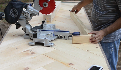

Step 7: Trimming the Top
After the glue had dried, I took the whole thing back outside and used a straight piece of wood as a guide for the circular saw to trim off the ends of what is now the table top.
For the long sides, I measured 15 inches from the center, then used a square to make sure the cuts were going to be perpendicular to the ends. As a guide I used an old OSB board I had in my shed, but because that board wasn’t straight, the waviness transferred over to the table top. Arg. Well, I took the piece I just cut off because that actually was straight on one side and used it as a guide to really get the edges straight.
Here, I realized that my edge trim was shorter than the table length after cutting the 45 degree miter on the trim, but I figured, "no problem. I’ll just trim a few inches off the back end of the table."
