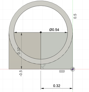

Step 2: Make the First Sketch
Start by making a sketch with these dimensions on the Z plane

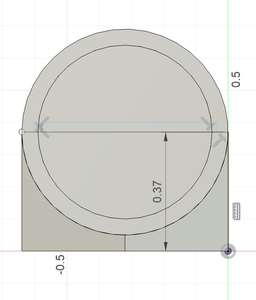

Step 4: Sketch #2
Create the following sketch on the X plane
Step 5: Extrusion #2
Now extrude it .37 inches

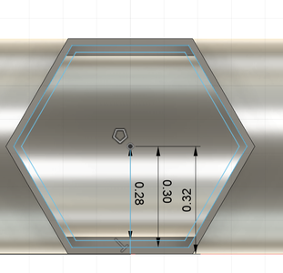

Step 6: Sketch #3
Keep following these sketches and dimentions
Step 7: Extrusion #3
Extrude it as depicted

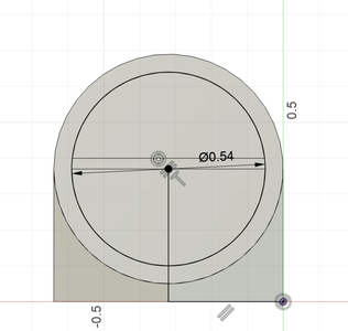

Step 8: Sketch #4
Step 9: Extrusion #4
Then cut it 2 inches

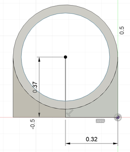

Step 10: Sketch #5

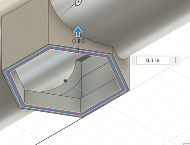

Step 11: Extrusion #5
Extrude that .1 inches

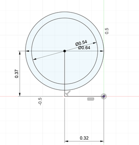

Step 12: Sketch #6
Step 13: Extrusion #6
Extrude it out 0.05 inches

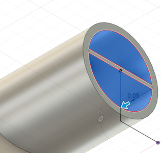

Step 17: Extrusion #8
Extrude it in 0.05 inches, and you are done with the design!
