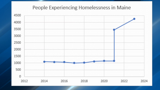

Step 1: Research – Why Maine? Why Hex Housing?
When I began this project, I was thinking a lot about how many people in Maine struggle with housing, especially during the cold months. Maine has one of the highest rates of homelessness in New England, and the shelters are often full. Additionally, housing in cities like Portland is becoming increasingly expensive, and there’s a shortage of affordable space available. So I asked myself: what kind of home would take up less space, be easy to build, still feel warm and safe, and actually look like a home?

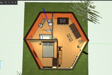

To map out my version, I sketched a bunch of floor plans. I tested what a single hex room would look like and then tried adding extra units around it, like one for a bathroom, one for a kitchen, and so on. The best part of using hex shapes is that they connect easily at angles, so I could play around with different layouts while keeping the structure strong and compact.
This step helped me shape my vision and make sure the design wasn't just cool-looking but also practical, modular, and expandable. I kept in mind that the house needed to be affordable, easy to build in batches, and still feel like a home, not just a shelter.

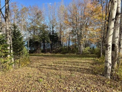

Step 3: Site Selection
For this project, I chose Maine as the location to imagine building these Hex Homes. I wanted a place where small, smart, sustainable houses could make a difference, and Maine stood out for a few big reasons.
First, Maine has a growing housing crisis, especially for low-income families, seasonal workers, and homeless individuals. There's a real shortage of affordable homes, and rents keep going up. That’s where my idea comes in: these compact hexagonal homes don’t take up much space but still feel complete and livable. They can be built on unused land or even grouped into small villages, so we can support people without needing huge developments.
Second, Maine has plenty of natural resources like wood, which is great for sustainable construction. I'm using oak wood, which fits perfectly with the region and supports local sourcing. Plus, Maine’s climate, cold winters, and lots of sunlight make it ideal for solar power and insulated wood structures. I designed the house with angled roofs to handle snow and placed windows to maximize light and heat during the day.
Finally, I thought about the vibe of the place. Maine has a mix of nature, community spirit, and openness to creative housing ideas. I can see these Hex Houses blending in with the landscape, especially in small towns or forest edges. They could offer a fresh start for someone who needs stability, dignity, and safety, without feeling like they’re stuck in a basic shelter. This site makes it real.

In the design process, I began by visualizing a compact and efficient living space that could realistically help sustainably solve homelessness. I chose a hexagonal structure for the house because it’s space-efficient and allows for easy expansion—multiple hex units can be connected like a honeycomb to form a small community without needing much land. Using Revit, I designed a micro-home that fits within 550–600 square feet, ideal for individuals or small families.
The layout includes a loft-style sleeping area, a foldable dining zone, a compact yet smart kitchen, and a sustainable bathroom setup. I selected oak wood as the primary building material because it is sturdy, weather-resistant, and eco-friendly. To further reduce environmental impact, I integrated features like solar panels on the roof, LED lighting, thermal insulation, and a rainwater collection system. The goal was to ensure that each unit could function off-grid and remain affordable while still feeling modern and dignified. Every element, from the materials to the layout, was carefully considered to balance cost, sustainability, and comfort for people in need of housing.
Step 5: Bedroom Module
The bedroom in this hex house is designed to be cozy, elevated, and space-efficient. It uses a loft-style setup where the bed is raised to create storage or workspace underneath. The walls are insulated using sustainable materials, and oak wood paneling adds warmth and durability. The window placement allows natural light to enter while maintaining privacy. Smart home features include automated lighting, a small heater for colder months in Maine, and a pull-out closet system for storing clothes and essentials. Everything is designed to fit within a minimal footprint without sacrificing comfort.
Step 6: Living Room Module
The living area doubles as a multi-use zone—functioning as a space to relax, work, and dine. Modular furniture like a fold-out couch, a wall-mounted desk, and a collapsible table make the area flexible and practical. The flooring is made from reclaimed oak, offering both beauty and sustainability. This module is designed to feel open despite the small size, with windows positioned to bring in natural light. A smart lighting system adapts to different moods and times of day, and built-in shelving helps keep things organized without cluttering the space.
