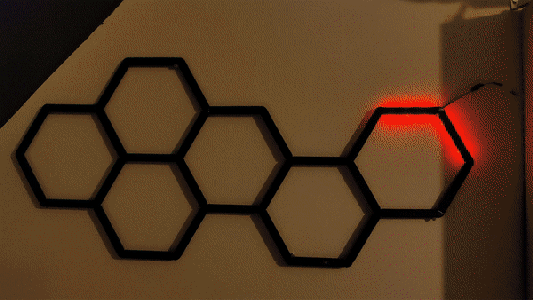

Introduction: Hexagon Light
Spice up your gaming setup with a LED-HEXAGON-LAMP! It is controlled by WLED and WS2811B diodes. It can be customized as much as you want. just let your imagination decide.

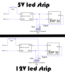

We needs to create the motherboard to control the lamp. For this, we will be using a ESP8266 (Any ESP will work).
Look at the schematic above, if you are using a 5V led strip use the 5V version and then the same for 12 V
Step 1:
Start buy placing you ESP on a prototype board and solder it in place. This is not needed but it makes it a lot easier in the long run.
Step 2:
Add the connectors. You need 2 connections, Power and output. You can also just solder the wires directly to the ESP but adding screw terminals makes it easier to disassembly if needed.
Step 3:
Adding wires between the terminal and ESP. You can follow the diagram above this section.

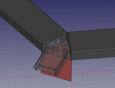

This step requires a lot of time. each part will take between 5 min to 2 hours. You can make the lamp as big or small as you want. Only your imaginations will limit what you can do. There are 3 parts: 2 connectors and 1 beam.
The connectors have eighter 2 or 3 connection points.
- 60 degrees has 3 connections.
- 120 degrees has 2 connections.
There is no need for support, the models already have support integrated. It took me around 72 printing hours to complete my lamp parts. Il recommends printing a lot of parts in one go, just like shown in the pictures above.

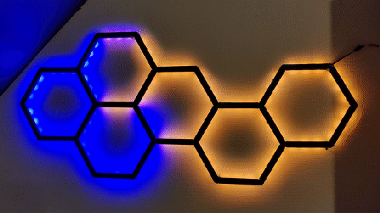

The Hexagons
Now for the assembly. To assembly, the parts simply remove the support and slide the parts together in your desired pattern. To lock them, remove the protection from the led strips, and use the sticky side to cover the joints. See the pictures above. Now repeat this part for the whole lamp. Make sure the arrows follow the path that you want to create. You can add on a long line, or make some jumps from the mainline (I did this)

The different height of spacers is for different types of led Strips.
Few LED pr. meter = Tall spacers.
Many LED pr. meter = Shorter spacers.
You can think of this in one way. The wall is your defuser, so If you have a 3 led pr. 5 cm. Then you need to more distance to the wall, than when you have 5 led pr 5 cm. This is to avoid the hot spots, see pictures above.
Step 6: And Done
Now you are done with your Hexagon lamp. Good job.
