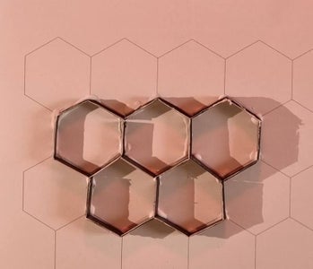

Step 1: The Prototype
You do not need to build a prototype. I just want you to show how I came to the idea of creating this display.
I had the idea of creating a LED matrix display which is not made up of quadratic pixels but of hexagonal pixels. So I printed a hexagonal pattern which you can create on your on online e.g. here and glued it to some cardboard. Then I cut and glued my LED strip to it. I soldered them together, so they can be adressed as one strip. Since I wanted a hexagonal display I glued some hexagonal framing on a piece of paper which should act as diffusor.
With a sketch for a linear strip I tested it with my diffusor and also with a plain sheet of paper.
The hexagonal framing worked fine when it was near to the LEDs, but it was also interesting when it was further away, because nice shadows appeared. This could of course be avoided with deeper framing. The tests with just a paper where also quite interesting, so I decided to go this way.
Since there have been build enough normal square pixel displays, it is time for something different. And since I didn't wanted to go the pixel art way, but more the abstract way this was the way to go. By the way... I wonder how pixel art would look like on a hexagonal display?
So the decision was done to follow the diffusor only way...
