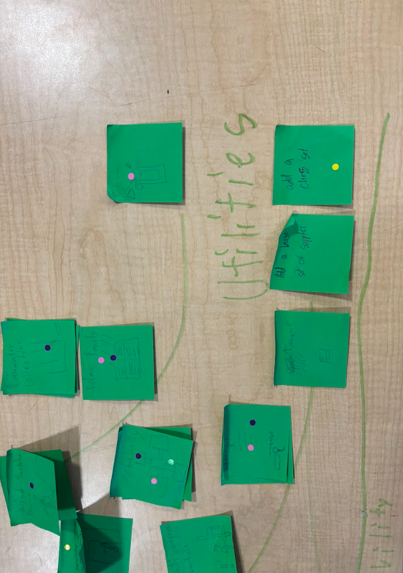

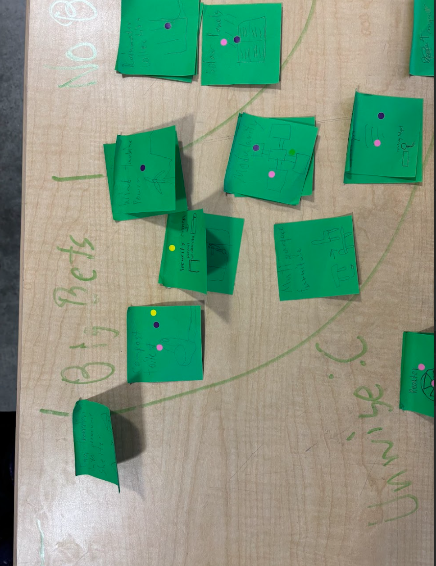

I also designed a prioritization grid, where various features were brainstormed to add to the design, and then ranked on the board based on user design and viability (pictures to view this in are in the above section).

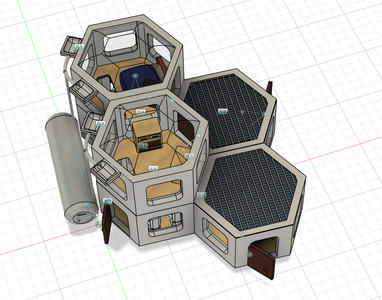

Step 2: Model a Base Hexagon House
I started the process of modeling with making a base house as a component, which could then be duplicated, stacked, and filled with furniture as needed.
  1. I first started with a hexagonal base sketch.
  2. I extruded up walls on the sides.
  3. I then cut into these walls to create windows.
  4. Finally, I added a roof and textured everything.
Step 3: Create the House Layout
  1. I copied and pasted the components, using the paste new function to allow myself to make edits to the houses.
  2. I extruded the roof up with a taper, which will be useful during rain to make sure the water doesn't gather on the roof and collapse it.
  3. I jointed each component with each other at the end to make sure they were exactly joined.
Step 4: Solar Panel and Filtration Systems
  1. I made a sketch with two rectangular patterns perpendicular to each other to create a solar panel like effect.
  2. The rainwater collection buckets on the top started as a rectangular prism. I used a bunch of sketches and fillets to get the desired shape.
  3. This water storage is a cylinder that has the ends filleted and a hatch/viewing port was modeled onto it.
  4. The pipes connecting the parts are cylinders created using the sweep tool.
Step 5: Furnishing & Renders
I added modeled furniture, textured the floors, and added doors. These were nice finishing touches to the design that really brought it to life.
  1. My chairs were pretty basic, just modeled from a few extruded rectangular prisms.
  2. The bed was created using create form and T-Splines.
  3. The cabinets were a combination of extrusions an fillets.
  4. The toilets/sink were created by create form.
  5. The doors are jointed with a revolve joint so they actually swing, although there are no hinges actually on there due to time constraints.
  6. There are ladders from holes in the floors, which allows for easy access between the first and second floors.
I rendered the model in blender, utilizing the .fbx file format which made the conversion convenient. I used the cycles engine to make the glass have realistic results.
