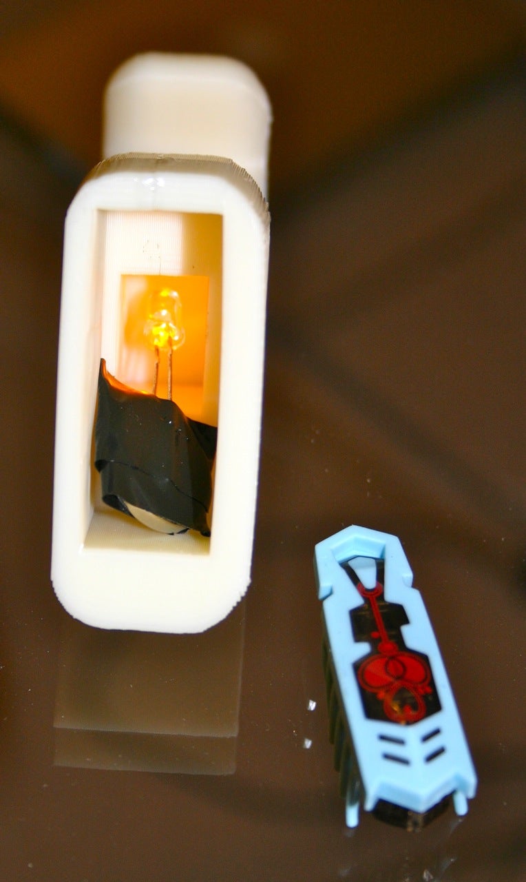

This is the top, front view of a finished ghost.
Step 16:
This is the bottom.
Step 17:
Tape a led to a 2032 battery--long led leg on the "+" side of the battery.
Step 18:
Insert the glowing led. Turn on the hexbug and insert it.
Step 19:
Put the ghost down on a table and watch it go. You can print ghosts from different colors of plastic, and you can use different colors of led for eyes--making lots of different ghosts.
