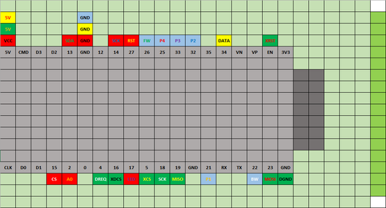

Step 1: Plan Ahead (the Hardware)
For me this was the most difficult and easiest part of all this process. Difficult because with my "expertise" I used pins that didn't serve the purpose I was looking for. At first it was trial and error, and later I had to read the documentation for the ESP32 and learn about the use of each pin to understand better what I was doing. After that, it was so easy to plan, solder and mount everything in place!!
First of all, I recommend you enfatically to plan ahead all the things you'll use and connections you want to make. I assume you'll make a variant of this model, so I "enforce" you to read the compatibility of the different pins of the ESP32 so you don't have troubles (like I did at some points, not every pin is useful for everything).
Before all, I made a PCB board map on a spreadsheet, 'put' the ESP32 above it and marked each square of one color for each component, and later, a color of font for each cable color I would use.
I used a Proto PCB to mount the ESP32 and ease the soldering for each small pin, very useful in those cases where pins are shared (5V or ground).
For the TFT, the MP3 decoder and the IR receiver instead of soldering, I used JST plugs for each one of them; the other end of the cables were 'free' to solder into the Proto PCB.
The antenna connects directly to the ESP32 board through its PCI U.FL IPX plug.
Finally for the buttons: I mounted them on another Proto PCB board not only to ease soldering, but also, to let them in a fixed position so I could put them on a case later on.
After all this, and looking at my "map" for pins, components and cable colors, the soldering was really easy.
At this point I recommend connecting the ESP32 and use the example libraries for each component (TFT, IR Receiver, MP3 Decoder, Buttons) to check if everything is working correctly. If so, it means that the soldering is fine. If something fails, check again the soldering before changing components (I had to desolder and solder again several times until all worked properly). When everything is fine, I also recommend to use a glue gun on the solderings, this way when you move all the components and cables, you'll reduce the chance of disconnecting something.
A final warning: be very careful that no pins are making contact with each other before powering it up. I fried 2 ESP for not soldering properly and making a shortcircuit with some pins.
