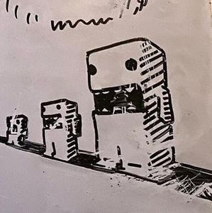

I had no real idea what or who "Hidari" actually is, but this image crossed my Instagram feed, and my immediate thought was; I can make that!
Looking at the account's profile, I think it's a team making a stop-motion film, and it might be based on characters drawn by a Japanese illustrator called Hidari, but the translate function on my phone app refused to deal with the pictograms in the text. If anybody is able to enlighten me further, I'd love to know more.
Anyhoo, on with the instructable...
You'll either need paper, pencil and ruler to copy the template by hand, or you need to print out the attached PDF or SVG files that I drew in Inkscape. It has four copies of the same model. If you're working from the photo, you need to know that each square is 5mm across.

So, that's one model made, but the sketch in the source suggests that it should be part of a long row of figures. How long a row is up to you, but for now, Hidari is being made welcome by the Inch-High Guys...
