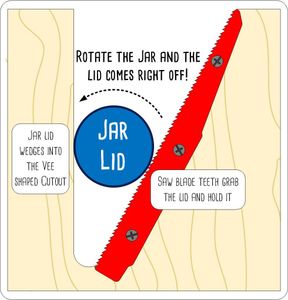

Two pieces of wood are used to support a reciprocating saw blade. This is mounted in such a way that there is a vee-shaped channel.
You press the jar into the vee until it’s tight, then twist the jar in a clockwise manner. The Vee shape keeps it pressed tight up against the teeth on the saw blade, which grabs the lid. You will hear the lid pop and then you know that it’s open!

We've attached a digital copy of our design, but our initial design was actually all drawn by hand.
We started with a blank sheet of paper and Rachel traced a small bottle cap for the bottom of the Vee. Then she drew tangential lines to form the Vee shape, and traced over the blade.
If you would like to skip this step, just print off 2 copies of the sheet that we have attached. You can glue them both following the next step. We have also attached SVG files if you'd like to CNC or Lasercut the wood.
