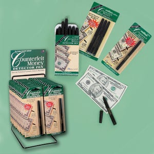

First I should explain how the counterfeit money detecting markers work.
These markers are basically just a marker filled with iodine. When you write on a bill, the iodine either turns yellow or brown based on the amount of starch in the paper.
The US paper currency does not have any starch in them, so if you write on them with one of these markers, the line turns yellow. Normal paper does have starch in it, so writing on a counterfeit bill will result in a brown line.
The marker will fail if you have counterfeit money which doesn't have starch in the paper or you have real money with starch in it (or on it)
