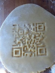

We rolled the cookies really thin then pressed the stamp into the cookie.

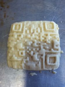

Then baked them quickly so they wouldnt rise. and distort the QR code.
It took us several tries to get a QR code to scan. We will keep refining this idea.
