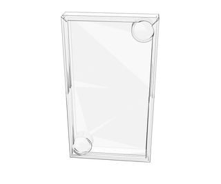

You will need a two neodymium magnets if you are planing to use the STL file from Step 2.Size of the magnets 6.3 mm in diameter, which I bought for an Art and craft store called Michaels
But if you are not comfortable inserting the magnets while printing as shown in the pictures in Step 2, you will also need,Hot glue gun or just super glue should work fine.

Step 2: 3D Print Base With the Magnets
Download the 3D printing software that your printer supports, in my case I am using the Printrbot Simple Metal which use Repetier-Host as a software to
  • Slice the STL files attached,which basically means cutting the part into various layers
  • And send commands to the 3D printer while printing
In my case I am using the following filaments HATCHBOX 1.75mm Black PLA
Now while 3D printing keep checking if the height of the Magnet is reached so that you can insert it into the box, since I am using a Printrbot simple metal which does not have an enclosure around it this is much easier to do as shown in the picture above.
Once your are comfortable the height of the 3D printed base is slightly higher , pause the pint and add the magnets as shown in the video above.
Note : Now in case you don't have a 3D pinter you can always use a 3D printing service like 3DHubs OR if you have a 3D printer whose extruder is magnetic use the STL fileattached in Step 3 and glueand not the one above.

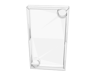

Step 5: Glue the Magnets in the Box
Apply hot glue to the bottom of the magnets and place the magnets in the 3D printed part and press and hold for 30 seconds
Also top off the magnets with some more glue as shown in the second picture.
Congratulations you have successfully complete the Hide A Key build !! And you have a spare to prevent you from lock out.
