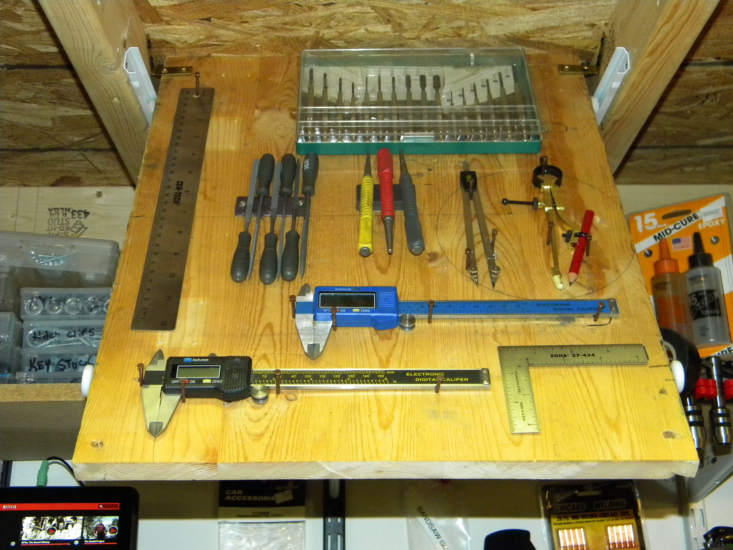

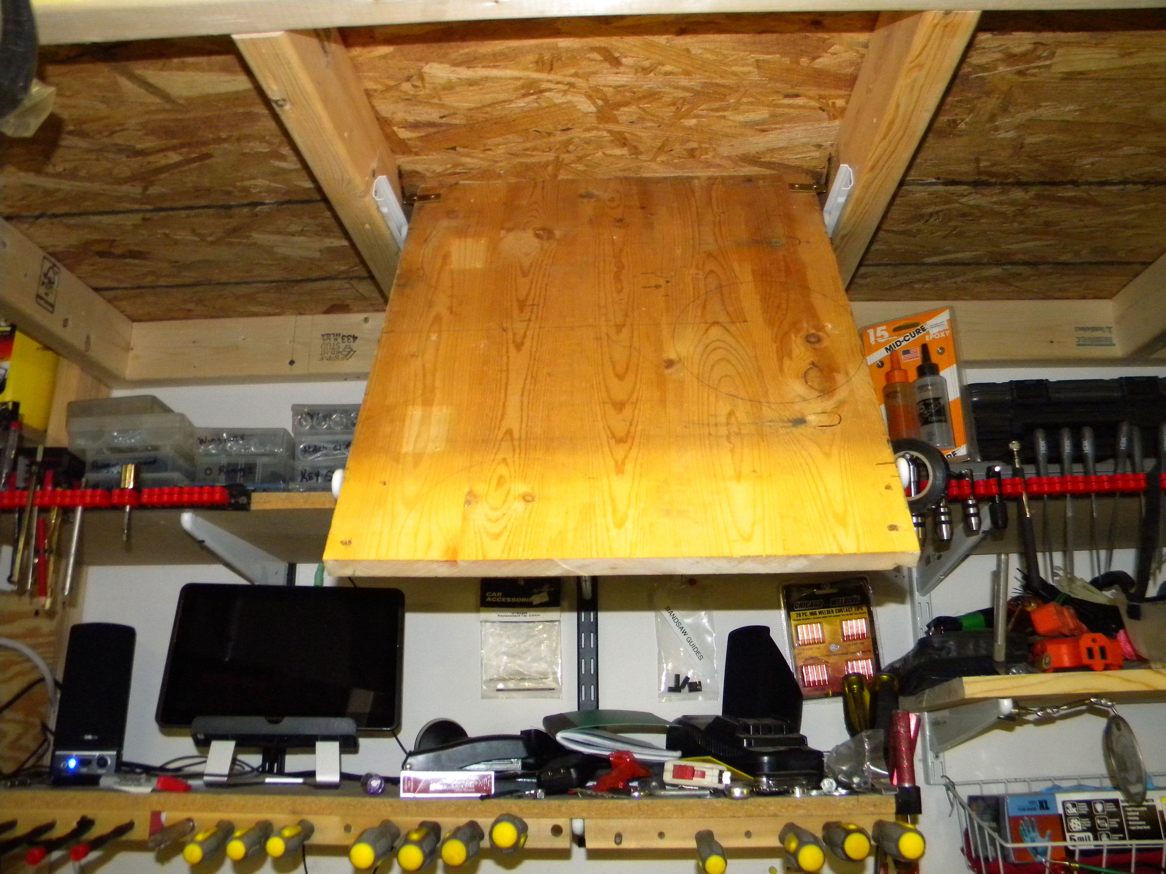

The purpose of this instructable is to use wasted space . I built a new workbench in my garage/work space but still did not have enough room for all my tools to be easily accessible so I came up with the slide -n- hide

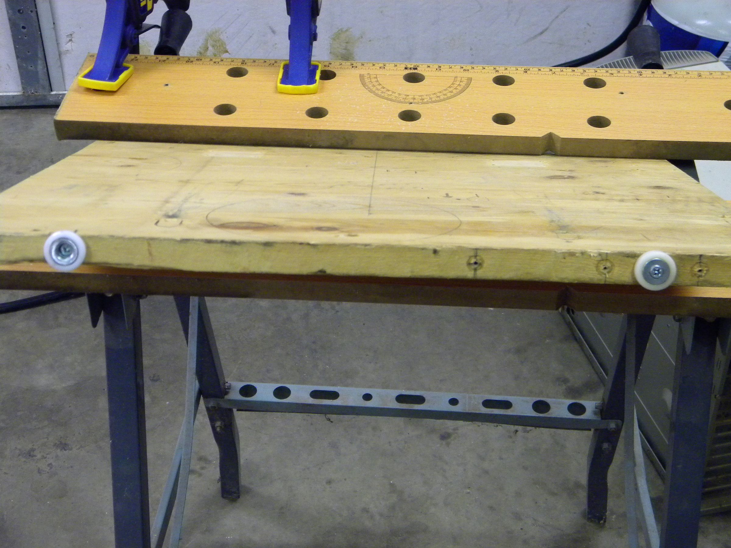

measure on your board 3 inches from the end you want in the back and mount the 2 shower rollers ( with the nut side towards the board ) the #6 x 1 1/2 flathead screws also mount the front rollers same method but  you need 2 small flat washers the will allow it to roll when tightened

mount your board into your sliders (back rollers only as you want to mark your desired limit of the pull down )
Step 7
position your board to the desired spot you want it to stop and mark your side walls
Step 8
install you L brackets at the angle you want the board to stop
Step 9
install your board to see if everything works as desired

now you can attach anything you like to the board
