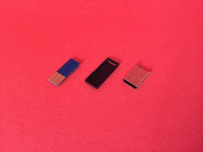

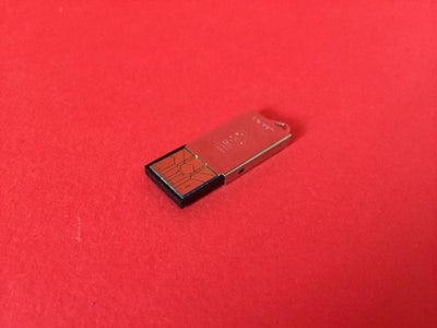

Step 2: Dismount the Thin USB
Dismount the USB pendrive.
We need just the circuit, so I simply removed the metal and the plastic part by pulling them off.
NOTE: This step could be avoid of you use a Mini USB pendrive. I had this thin 8GB pen laying around so I used it.

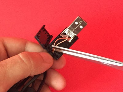

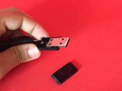

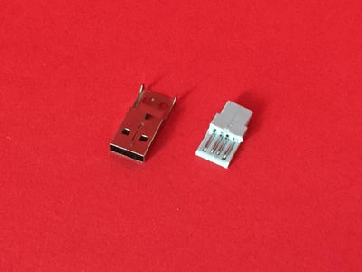

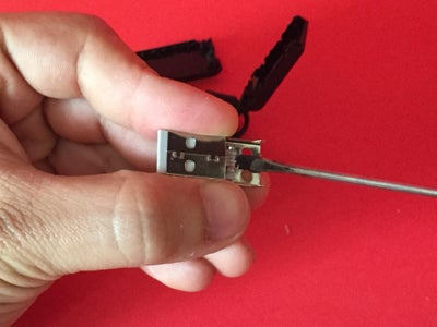

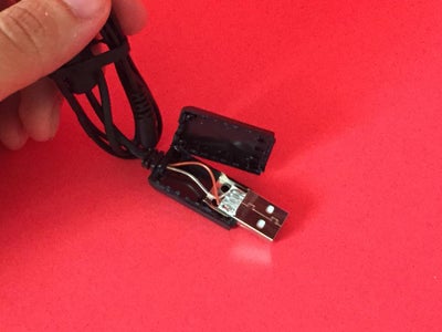

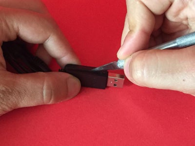

Step 3: Dismount the Charging Cable
In order to dismount the USB connector, you have to cut along the line on its sides.
Once you opened it, cut the wires, remove the white plastic piece with a screwdriver and keep the metal piece.
NOTE: Again, if you use a Mini USB pendrive, you don't have to keep the metal piece.

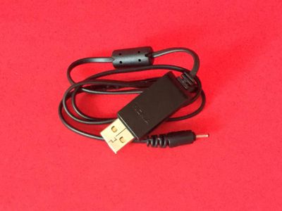

Step 4: Modify the Thin USB
Since I used a thin USB pendrive I had to add a small white rectangular piece to make it look as a normal USB plug.
So I simply cut it from an eraser, and I glued it under the pendrive's circuit.
Finally I inserted it in the metal piece and, as you can see in photo #4, it really looks like a normal USB connector.
Step 5: Re Glue the Charging Cable
Put it into the USB side of the charging cable, and re glue the black plastic cover in place.
Be sure to keep it pressed until it dries, so there will be not visible signs.
