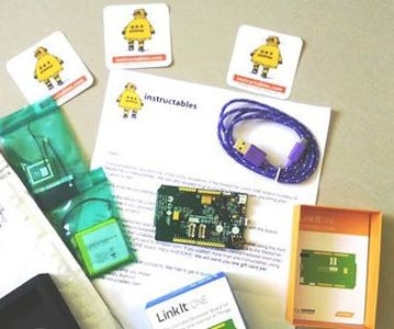

This instructable will teach you to build a Hi-Fi audio system using Linkit ONE......u can able to control audio using IR remote

- Linkit ONE
- Arduino UNO
- LCD with LCD shield
- Sd card
- Speakers
- IR remote
- Tsop1738 (connect Vcc of tsop to 3.3v as Linkit ONE is 3.3v tolerant)
