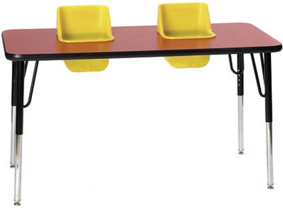

While searching for an alternative to having two high chairs, I stumbled across this fantastic setup. In the original, they sacraficed a table, in my case I built a special leaf for the table instead. The original can be found here: http://jared-krystal.blogspot.com/2010/11/ultimate-twin-high-chair.html
The chair inserts are designed for toddler feed and play tables let the one below.
