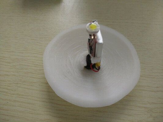

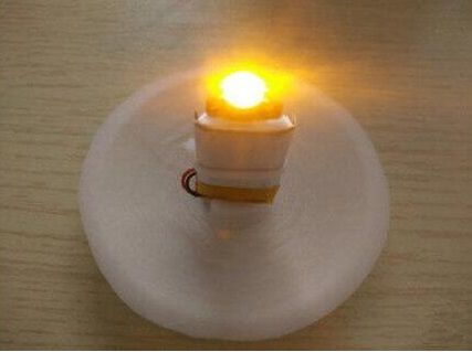

Step 10: Improvement 6: Light Source
If your printing material have some color variance (in most case yellow), it is better select warm white LED light. Otherwise, select normal white LED.
This time I have tried 2 portable light source and 1 USB light source.
First one is a cup bottom decoration light, usually it use at night club or bar. The PCB is only 28 mm in diameter and powered by a tiny CR1620 battery. Limited from the battery power, the LED light is not so bright but it should be good enough for a 2-3 inches Moon model.
Second one is a 120 mm ball light, I disassembled the ball cover and will replace it with a 5 inches Moon model. It use rechargeable battery, much brighter LED light and can remote control the light color and brightness.
Third one is a USB powered desktop wood lamp base, it can mount a 150 mm ball shape lampshade on it.

Step 17: Process 6: Install Light Source
Follow the above pictures for the installation.
