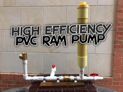

I built four variations of hydraulic ram pump to test the efficiency of each and find out which one was best.
On the attached images you can see that there is a linear and a perpendicular variation as well as each variation with and without an air pressure chamber, the addition of this air chamber is said to improve the efficiency of the pump by generating more pressure for the water to flow out of the ram pump.

Step 1: Efficiency Testing
To test the efficiency of each variation of the hydraulic ram pump I went to a nearby stream and measured the volumetric flow of water from the intake pipe with a graduated cylinder and a chronometer, the height difference of the intake pipe and the intake of the pump was 30 cm.
As for the output I used the same equipment to measure the volumetric flow of water coming out of the hose at a height of 1,5 meters from the level of the hydraulic pump.
Efficiency for these types of pumps is measured by the relationship between the output and input power of the pump and the power is itself the product of the volumetric flow and the height at both the intake and output of the pump (In the image you can see how this is calculated).
With all the gathered data the perpendicular variation of the hydraulic ram pump is more efficient than the linear variation and adding an air chamber also increases the efficiency of the pump. The numerical results of this test can be found in the images.
The perpendicular variation is more efficient than the linear variation because when water flows due to one of the check valves closing it flows mostly in the direction of the output of the pump, while in the linear variation water flows almost equally through the output and the intake of the pump, generating a loss in efficiency due to the water that is being sent back to the intake of the pump.
