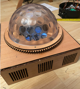

The gear/cogs were going to be a major problem. You can’t just draw them out and guess how the teeth mesh together.
I could have used a belt system to turn the dome but I thought that a cog would be more interesting. Besides, the bearing didn’t like to be pulled under tension because it would unseat from its bearing surface. A cog would be less likely to cause a problem.
Luckily I found a really helpful site (shown above) where I could customise and download for free a suitable set of gears in DXF format. I could rescale these in SerifDraw to what I wanted afterwards.
I used a Sculpfun S9 laser cutter. The cogs came out better than I expected. I only use cheap ply from a local wood yard. The ply on eBay is very expensive in comparison. If a cog was to have a weak tooth due to a gap/void in the wood I would just cut another and another until I got a good one. The first version was fine.
The second time I added some screwdriver access holes for the screws that hold down the bearing.
The gears mesh well, although there is a bit of friction. Exterior wood glue on the teeth improved the friction and made them a bit more resilient.
I will eventually make the smaller gear out of acrylic and this will reduce friction and the size of motor needed to drive it.
I also cut out the hole for the motor in the smaller cog at the same time making sure that the ‘D’ shaped profile was included so that it would be a friction fit and would not slip around. I cut two and joined them together to make it easier to align the cogs and compensate for any wandering as the bearing is not that perfect.
Next the outer ring was cut out that would hold and support the old dome lens. I could hot glue gun the dome in position later when its complete.
There is also a wide ring underneath to allow more wood depth for the screws to hold onto.

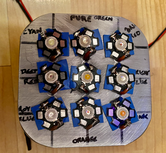

LED's and Heat
The heat sink was marked out for 9 LED’s. I couldn’t fit a tenth on.
I drilled through the heat sink to allow the wires to go through.
Be prepared to break a few drills, aluminium is tough stuff. Wear safety glasses.
The LED’s were attached to colour coded wires so I knew which was the positive and negative connections.
I used silicon heat transfer pads cut to size to glue down the LED's onto the aluminium heatsink.
I then joined the LED's in ‘series’ ready for the power supply which would accept 8-10 bulbs and give them the correct voltage and limit the current. There are lots of YouTube tutorials showing what series connections are and why they are used. This guy does a demonstration of what happens which is really practical compared to those that just like the sound of their own voice! (if you know what I mean)
https://www.youtube.com/watch?v=VrL_WN3Xcho (screenshot shown above)

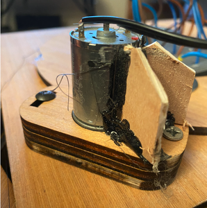

The Motor (see video)
I cut out 3 supports in ply for the geared motor and glued them together in a stack. The hole had 0.3 mm clearance (oversize) to allow the motor to fit snugly.
I hot glued on some supports to keep the motor at 90 degrees to the top surface.
An elongated slot one side allows for sideways adjustment so I could control how much of the teeth meshed.
I didn’t mesh the gears tightly, doesn’t need it.
The supports were added oversize so that they could be trimmed later when I had made up my mind how strong they looked to be.

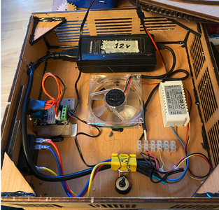

The Box
I laser cut a box out of 4mm ply. This has lots of venting and a mounting for the cooling fan.
It fixed together with hot glue.
There are 2cm feet underneath to allow for air flow.

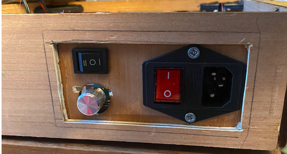

I made an additional recessed mounting for the mains connection, switch and the motor speed controller.
The speed controller is called 'PWM DC Motor Reversible Variable Switch Speed Controller Driver 3A 6V 12V 24V'
My circuit board was clearly labelled for the motor connection and voltage supply.
The lights work off a mains 230v supply unit that used to being to a laptop. The small cog motor and the cooling fan both use a small mains AC voltage to 12v DC supply that fits in the box.
