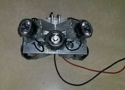

Step 2: Rear LED Heatsink
  1. Cut the aluminum.
  2. Drill holes on the flat for attaching two aluminum angles on each side and the rear LED. The four 45 degree facing LEDs would attach to the angles.
  3. Make threaded holes on the edges of the four angles which would hold the side LEDs.
Step 3: Front LED Heatsink
Drill and tap four holes on the angles which would hold the front LED. The screws would protect the lens holder.
Step 4: LEDs Attached to the Heatsinks
Use JB Weld to attach the LEDs to the heatsinks.
Step 5: LEDs Wired
The LEDs will be wired in series. For extra flexibility, you can use silicone insulated wires.

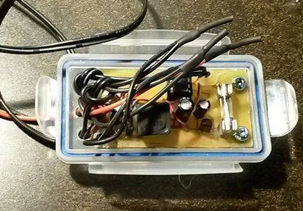

Step 8: Circuit
The circuit is similar to that of my daytime visible bike light except that it uses a step-up converter instead of a step-down converter. The LED's forward voltage must be higher than the battery's voltage. If you're using red or yellow LEDs, the battery's voltage should be less than 1.5V per LED to prevent them from glowing during standby. That means if there are six LEDs, your battery pack should not exceed 9V.

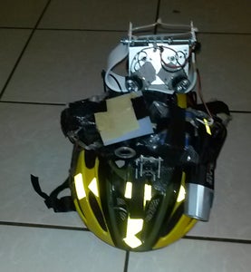

Step 11: Light Installed on the Helmet
Use velcro to attach the battery holder, front LED, and the circuit's enclosure to your helmet.
