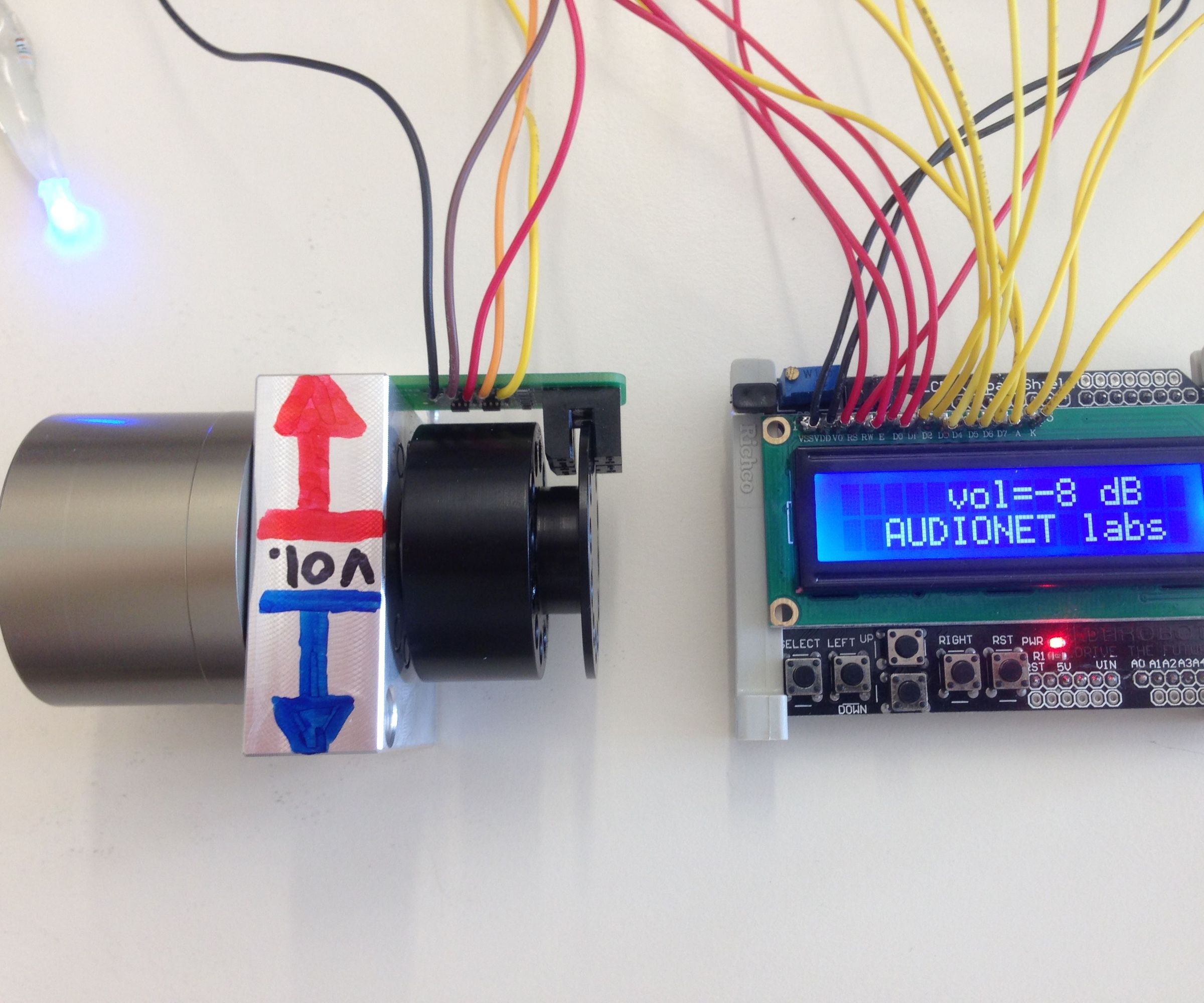

After the preffboard installation, LCD (16x2) Display comes as next and should be installed. I use mine in 4-bit mode to conserve GPIO ^_^))))))). Use 4-Bit mode please, otherwise, you won't have enough GPIO to complete the project. The back-light, Vcc and Gnd are soldered through a Potentiometer to power-bus. The display data-bus cables should be soldered directly to MSP-430 micrcocontroller. Please use only digital GPIO. The analog GPIO we need for the NTCs. There are 5 x NTC devices, so it's tight there.

It is always nice to have an input device, which can be used to input data into the device. The magnetic Knob with permanent magnets is a good choice here. Its task is to enter the temperature threshold for the fans mounted on the radiator block. It lets the user enter a new threshold for temperature via interrupts. Just by turning left or right, can add or subtract values in the range of (20-100 ° C). The lower value is determined by the room ambient temperature.
This Knob has a small circuitry which transmits the digital signal to the microcontroller. The logic high/low is then interpreted by GPIO for input.
