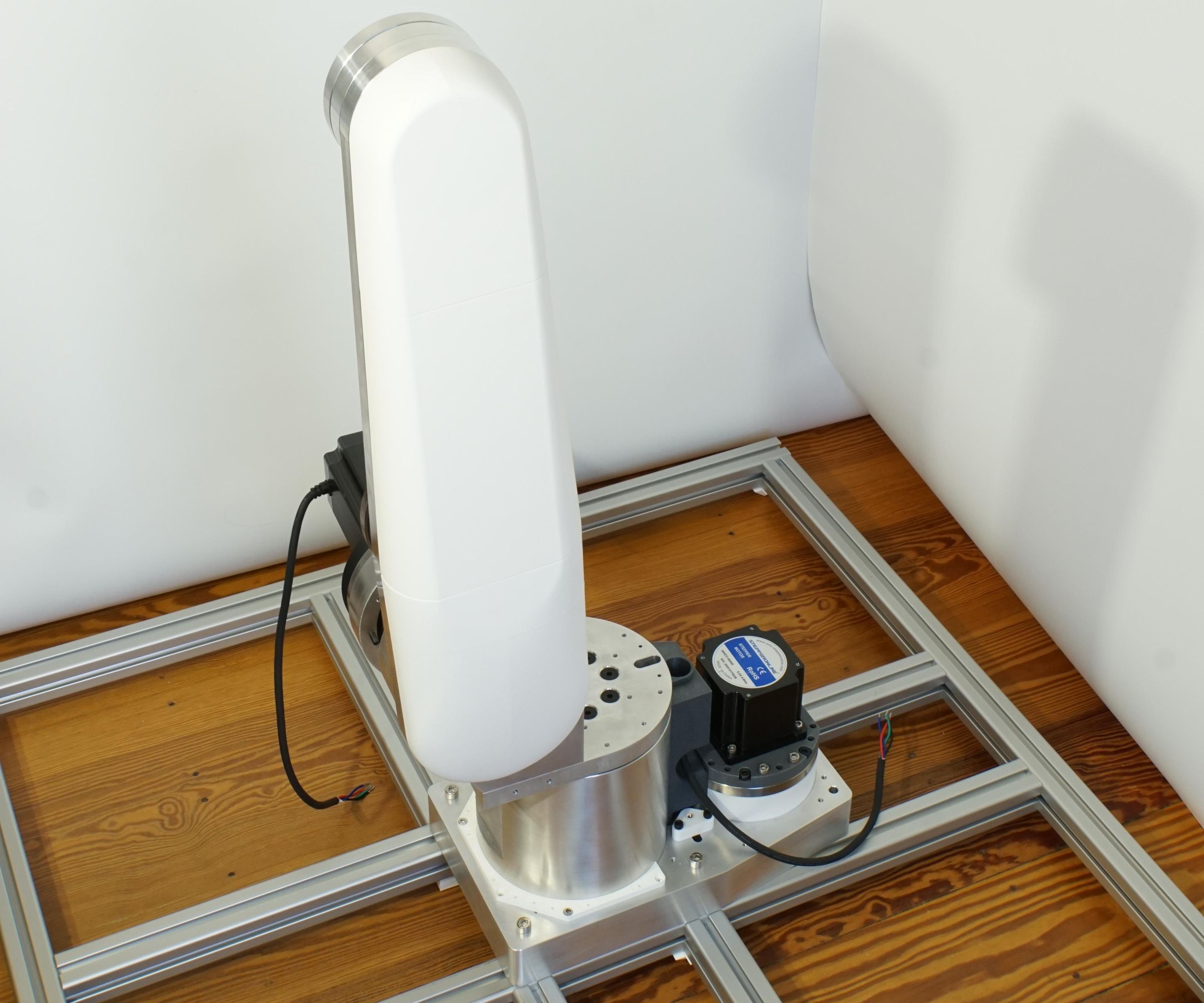

Introduction: High Precison Cycloidal Drive for Robotic Arm
I designed this cycloidal drive for my high strength robotic arm IRAS.
However, this design can easily be adapted or changed for your personal needs. The reduction is 1:43 and the drive has zero backlash and is torsionally stiff.
