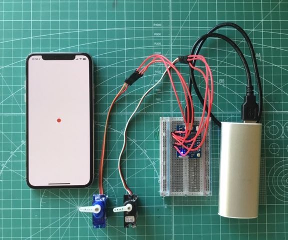

Introduction: High Resolution PWM Signal Generation for RC Servos With STM32 Devices
Currently, I'm building an RC transmitter/receiver based on the SX1280 RF chip. One of the goal for the project is that I want 12 bit servo resolution from the sticks all away down to the servos. Partly because modern digital servos have 12 bit resolution secondly a high-end transmitter is using 12 bits anyway. I was investigating how I can generate high resolution PWM signals on STM32 devices. I'm using black pill (STM32F103C8T8) at the moment for the prototype.

Step 3: Cascading Timers for Higher Resolution
The main problem with previous solution is that the frame rate (20 ms) is relatively high compared to the actually generated PWM signal (between 1 and 2 ms), so we are wasting some valued bits for the remaining 18 ms when we are waiting for the next frame. This can be solved by cascading timers using the timer link feature for synchronization.
The idea is that I'll use TIM1 as master to generate the frame rate (20 ms) and TIM2, TIM3 to cope with the PWM signals as slaves. When the master triggers the slaves they only generate a PWM signal in one pulse mode. Therefore I only need to cover 2 ms in those timers. Luckily you can cascade those timers in hardware so this synchronization does not need any intervention from the processor and it is very precise too, the jitter is in the ps region. You can see the CubeMX setup on the screenshots.
As you can see I selected 3 as prescalar so for the 2 ms I need to set 48000 in the timer's counter. This gives us 24000 for 1 ms which is actually more what we need for 14 bit resolution. Tadaaaa...
Please take a look at the oscilloscope screenshots in the intro for the final result. The channel 3 (purple) is the master timer's interrupt which will trigger the salves to generate one pulse. Channel 1 and 4 (yellow and green beam) are the actual PWM signals generated by different timers. Note that they are in sync but they are synced at the trailing edges, that is because of the PWM mode 2. This is not a problem, because the PWM rate for the particular servo is still correct.
Other benefit of this solution is that to change the frame rate would mean to change the period in TIM1 only. For modern digital servos you can go down to even 200-300 Hz, but please consult the servo's manual if you wanna fine tune.
