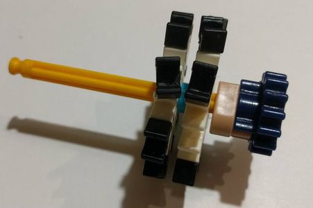

Step 2: The Orbital Gears
Build the orbital gear structure as shown using the snap gears.

Step 4: The Axles
Build the two axles as shown.
Note: the axles used in these instructions are yellow rods. However you may use whichever sized rods suit your application.
Step 5: Assembly
Attach the axles to the orbital gear structure as shown in pictures 1-2. Make sure that the gears are aligned properly. If they are not aligned properly it will create a lot of friction making it harder to turn.
Clip yellow rods on to the remaining black clips.
Once this is done make sure to pull the internal white connectors outward as far as they will go. This ensures the optimal pressure on the gears for the least amount of friction.
