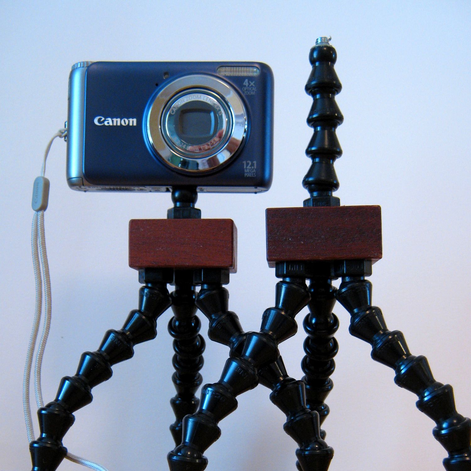

Arms
Loc-Line from ModularHose. This stuff is really fun and pretty expensive. Buy the pliers. Also, buy a lot because you will want to make other stuff using it. See the DeskSquid and GorillaPod instructables.

Step 15: Armed and Ready
Building the arms is as easy as clicking together the right parts, running wires through the Loc-Line hose and attaching the arms to the enclosure. The hardest part was finding appropriate nuts to use.
Because the thread on the Loc-Line hose is NPT (National Pipe Thread Tapered Thread) there are NOT nuts for it! At least not that I could find and I spent a lot of time looking. I ended up getting two brass connector fittings from a plumbing department, cutting off the end I did not want and grinding the remaining washer-like piece clean. If I were to do this again, I would look for a 1/4 inch thick piece of plastic and cut and tap my own washers.
Step 16: Assembled
Everything in place and ready to go. Arms attached and threaded with the LSR and laser. Plug and play!
