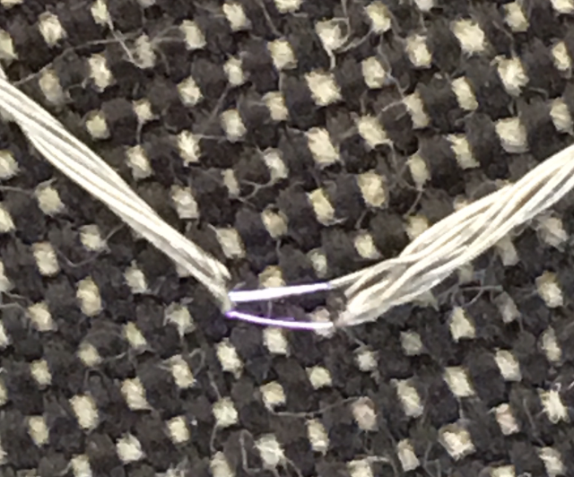

With the transformer driver OFF, connect the 2 blue wires from the driver to the 2 primary coil terminals/wires of the transformer. If you haven't already, connect 1 wire each to the two terminals of the secondary coil from the transformer. Make sure the ends of the 2 wires are stripped about a centimeter.
Step 3: Making Arcs
You can now turn on the transformer driver. making sure that you don't touch the stripped areas of the wires, slowly bring them together until you get an arc of electricity! mine usually gets to about 4 mm long. If nothing happens though, then immediately turn off the driver and refer to the troubleshooting page near the end of this instructable.
