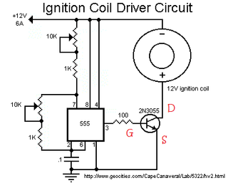

Step 3: The Driver Circuit Scematic
This is the driver circuit that powers the ignition coil .

    why dont you use a trap for the frequncy by measuring the frequncy ?
    you can put it right behind the transistor and the negative line.it should isolate the negative line with the spark.
    i draw it in the schematick below.

    i've got plans to build one of these eventually. Glad to see you're getting good sparks from yours. The reason 555s are dying in the back EMF from the coil. When the transistor turns off there's a WHOMPING great spike shoved up the power rails. This takes out the 555. Put a power diode across the coil with the cathode (pointy end, with the band) to the 12V rail. Also a 1000 microfarad 25V or so capacitor across the rails would help smooth out the load on the power supply and could give you better sparks.

    10 years ago on Step 3
    i used an irfp250 instead for the 2n3055. i got far much bigger spark and also when i used 32v of input to the mosfet the ignition coil was sparking to the concrete. the was super crazy. like a tesla coil. haahahahaha

    When you used the irfp250 did you connect it the same has the 2n3055 like this? or did you change anything? thanks!

    Reply 7 years ago on Step 3
    yes like this but substitute the 100R resistor to 150R else the gate will be too saturated

    I agree on your choice for using IRFP250n as not only a mosfet has a better rise/fall time in other words is more capable for fast switching, but it also incorporates a flyback diode for protecting the drive transistor from back EMF blowing all the circuit to nothing. A steering diode at the supply input would also be a wise idea to protect the circuit and improve commutation.

    I noticed the coils negative terminal is connected to positive, and vice versa, is it supposed to be like this?

    Reply 8 years ago on Introduction
    That portion is backwards, everything except the + and - on the Ignition coil is correct, just flip the two

    This doesn't work, I already fried 3 555 timers because of how the negative is connected to the chip and the high voltage goes into the chip and fries it.
