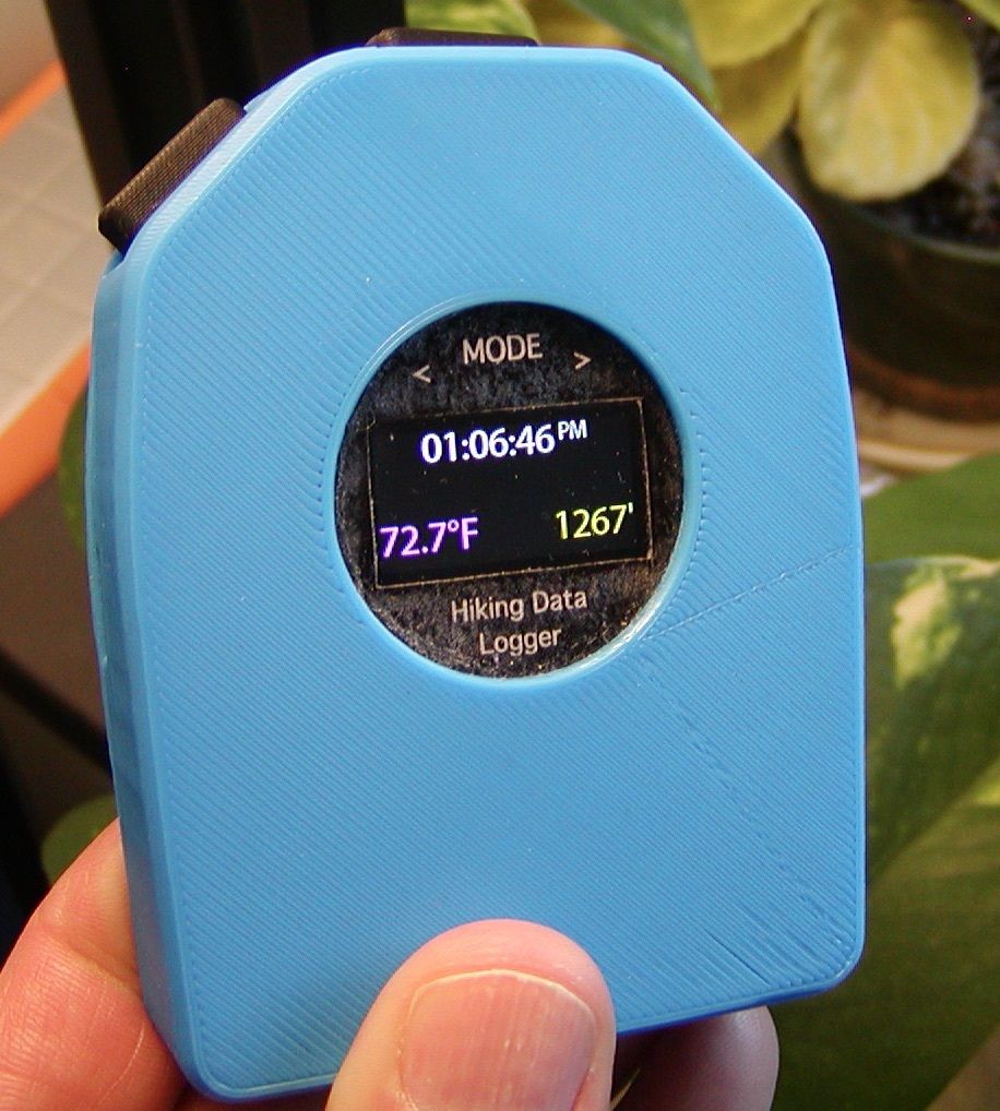

Introduction: Hiking Data Logger Using RFM69CW
This hiking data logger is used to record a hike’s location, start and end time, temperature, altitude and barometric pressures. It will also audibly report altitude milestones during the hike.
Even if you have no interest in hiking you may find the schematics, hardware and/or software useful.
The hiking data logger is made up of three separate devices and their Arduino projects.
All of the devices communicate using a HopeRF RFM69CW transceiver.
The three devices:
- Gateway - resides in your pack’s top pouch.
- Coordinates the recording of hike data.
- 5 button UI with a multi line RGB display
- SD card slot used for downloading saved hike data.
- Provides altitude milestone notification via an onboard MP3 player and micro speaker.
- USB serial and 10440 Li-ion 3.7V 600mAh AAA size battery with onboard charger
- 3D printed enclosure - 8 x 8 x 1.5cm - BMP280 remote - hangs on the back of your pack
- Broadcasts temperature and pressure updates every 4 seconds.
- The gateway and 3 button remote use the pressure readings to calculate the altitude.
- 10440 Li-ion 3.7V 600mAh AAA size battery that lasts several months on a single charge.

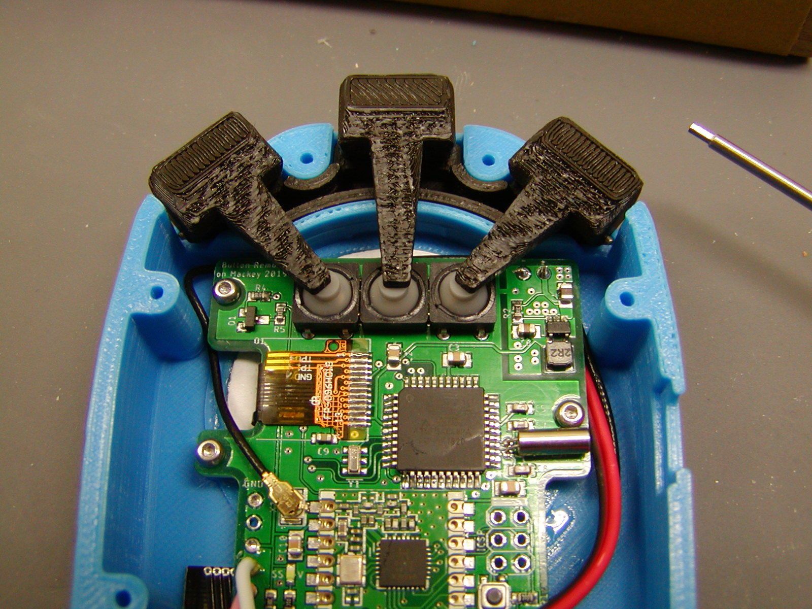

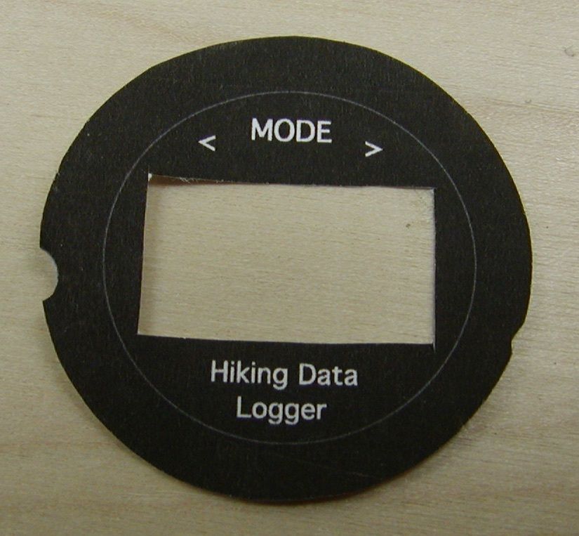

- 3D printed enclosure - water resistant - 8 x 5 x 1.5cm - Remote control - resides in an easily accessible pocket
- Controls and displays information about a subset of the gateway’s functions.
- 3 button UI with a multi line RGB display.
- USB serial and 10440 Li-ion 3.7V 600mAh AAA size battery with charger

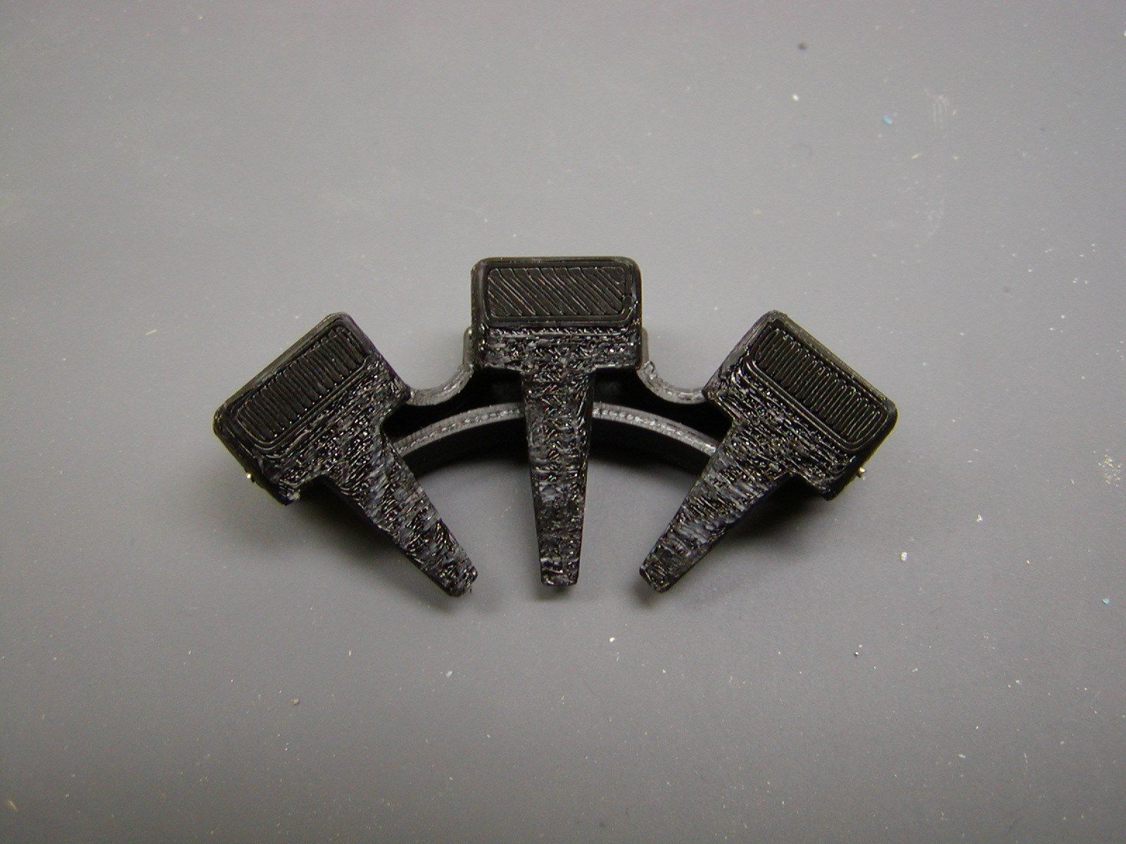

- 3D printed enclosure with buttons large enough to be used with winter gloves - 8 x 6 x 1.8cm

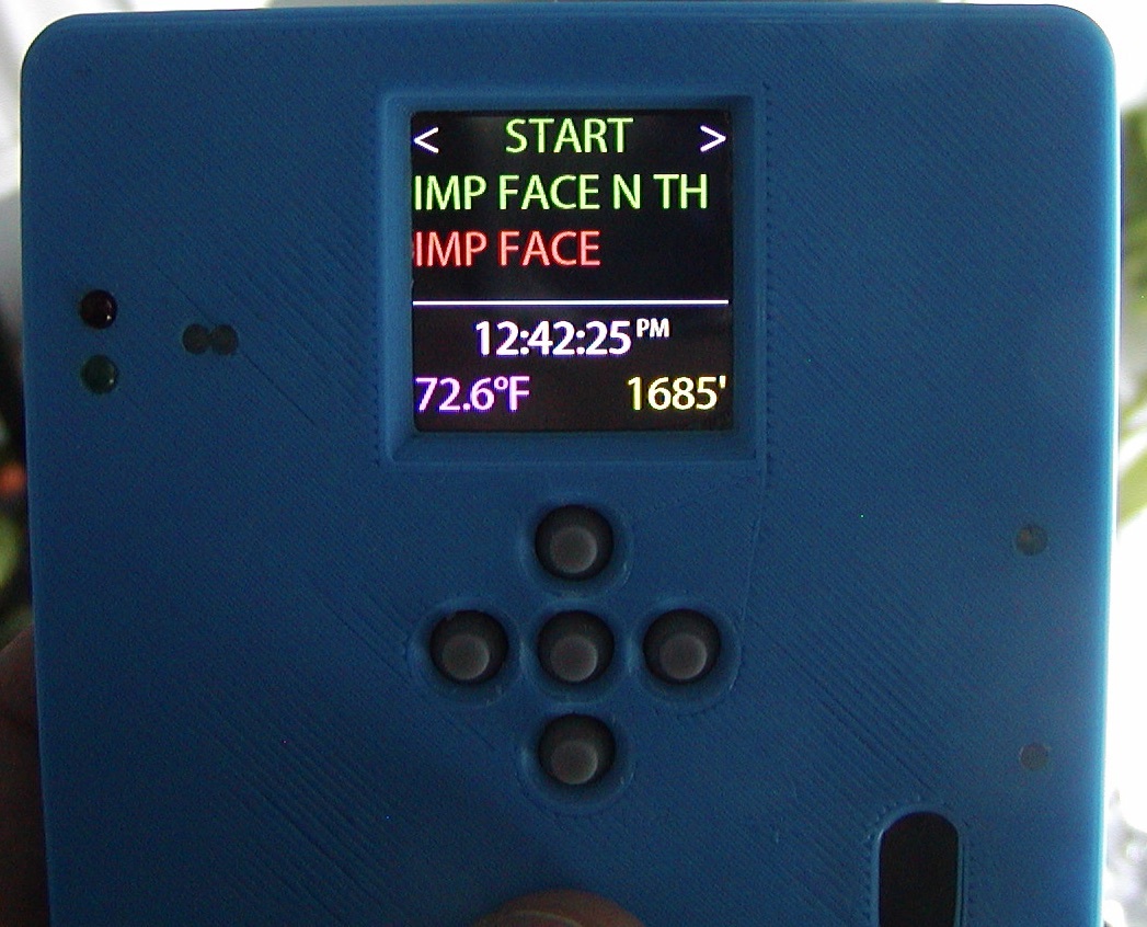

Setting the start and end location of a hike is done via the gateway’s UI. Once the setup is done the gateway can be placed in your pack. The 3 button remote is used to start, stop, pause, resume, and mark a hike as done. The only location setting action the 3 button remote can perform is swapping start and end locations (as you would do when going back the way you came.)
The 3 button remote controls a subset of the functions available on the gateway. The remote displays the current time, temperature and altitude. When logging a hike, the remote displays the elapsed time and percentage of the hike completed (in terms of elevation gain or loss.)

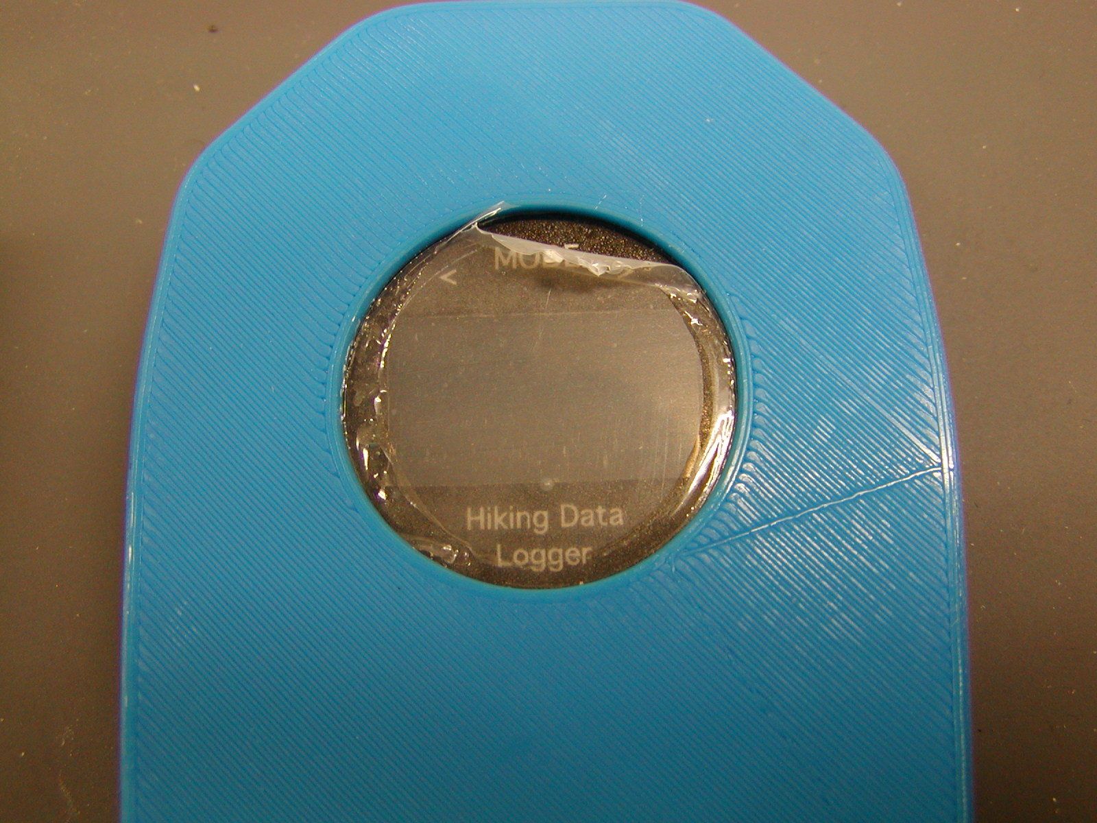

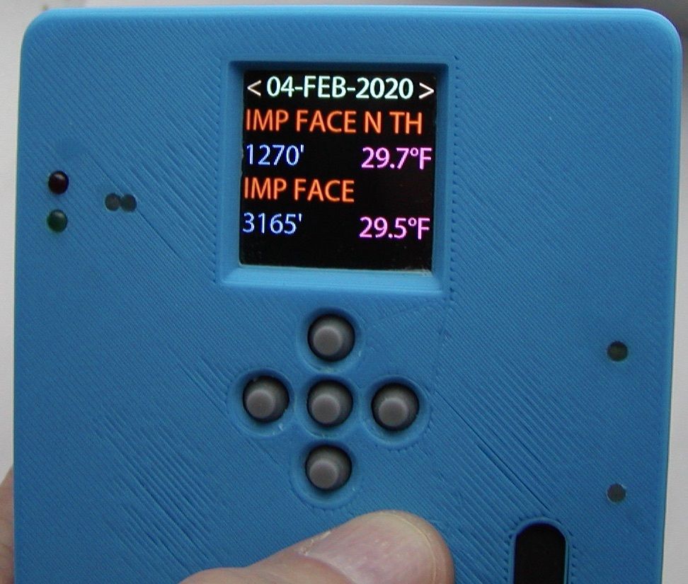

The Gateway Display:
The gateway display is textual, there are no icons. The display resolution, at about 10 points per millimeter, is quite high, higher than many computer monitors. For example my MacBook Pro with a Retina display is about 5 ppmm. For this reason the fonts used are antialiased. At 1.60 USD the 240x240 gateway display is a good value.

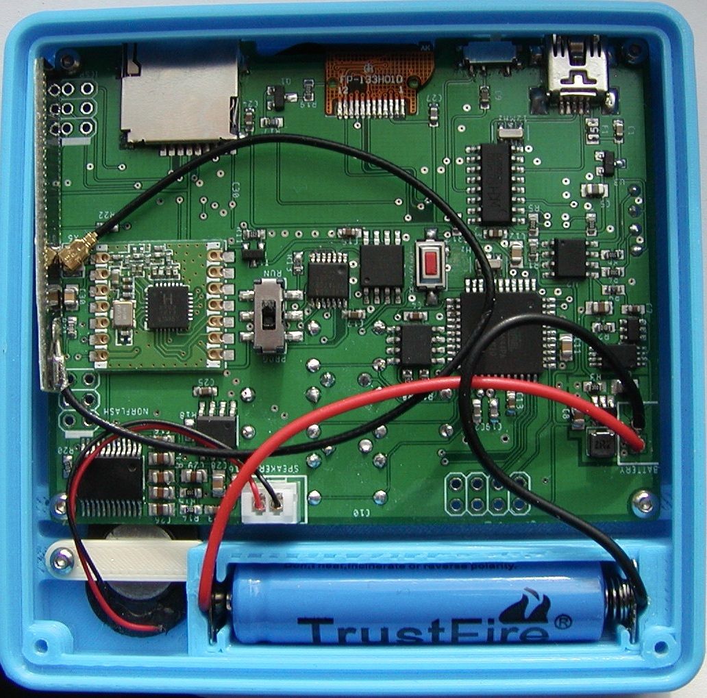

The gateway, notable components:
See the board shared on PCBWay for a full parts list.
- ATmega1284P MCU
- 240x240 ST7789 RGB display (source)
- RFM69CW transceiver (source)
- USB CH340G serial
- USB powered TP4056 Li-ion charger with FS8205A/DW01A protection ICs
- LM3671 DC-DC 3v3 converter (source)
- YX5200-24SS MP3 player (same IC used in the common DF Player module) (source)
- 8002A mono amplifier connected to a micro speaker
- W25Q64FVSS 8MB SPI NORFLASH MP3 storage memory (could have used smaller size, 1MB, etc.)
- AT24C256N 32KB I2C EEPROM hike data memory (or larger, AT24C1024, etc.)
- DS3231 Real Time Clock
The 3 button remote, notable components:
Main board
- ATmega644PA or ATmega1284P MCU
- 80x160 ST7735 RGB display (source)

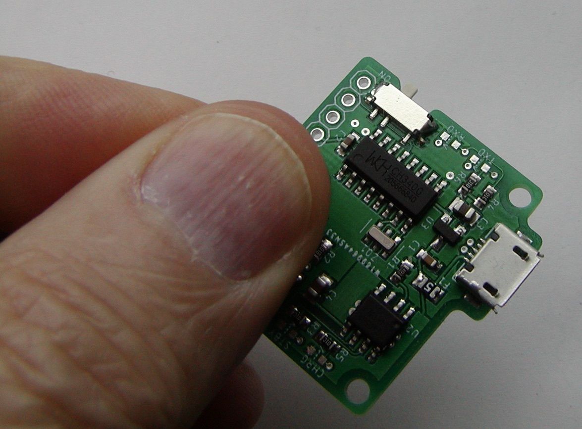

USB Serial & Charger board
- USB CH340G serial
The BMP280 remote, notable components:
- ATtiny84A MCU
- BMP280 digital pressure and temperature sensor (source)

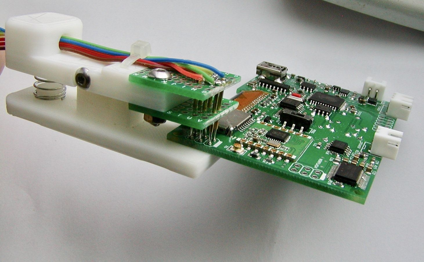

Step 2: Assembling the Boards
I’ve written several instructables that have step by step instructions for assembling a board with surface mount devices (SMD.) For this instructable I will only describe the assembly of the 3 button remote board in detail and how to solder the display cables for the gateway board. Once you’ve assembled one SMD board you should be able to apply that to most other boards.
Step 3: Assembling the 3 Button Remote Board
Instructions for assembling the board (or almost any small board) follows. If you know how to assemble an SMD board, jump to step 9.
Using a small piece of wood as a mounting block, I wedge the board between two pieces of scrap prototype board. The prototype boards are held to the mounting block with double stick tape (no tape on the PCB itself).

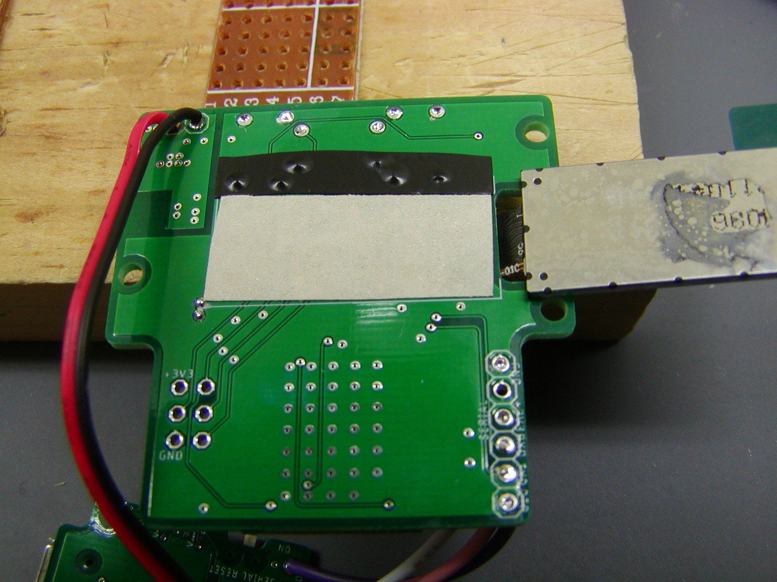

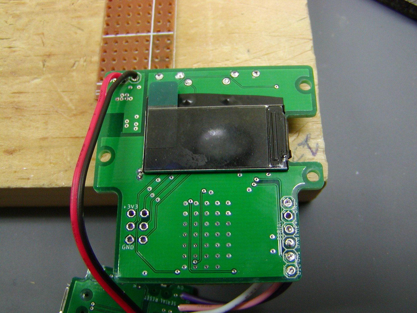

Special Board Assembly technique for displays
After melting the solder, this is where you would mount the the display. Apply a very thin layer of no-clean flux to the display cable solder pads. Position the display cable using double stick tape on the display metal frame to hold the display cable in position over the solder pads on the board. Using a pencil tipped soldering iron, gently swipe each pad on the exposed side of the display cable, repeating till the display cable sits flat on the board. Use a narrow piece of PCB to hold the cable down as you solder it. I’ve found this technique works better than attempting to use the hot air gun.
After melting the solder, this is where you would mount the BMP280 sensor on the BMP280 sensor board. At this point the pads for the BMP280 should only have slight bumps of melted solder on them. Apply a very thin film of no-clean solder paste on underside of the sensor. Place the sensor on the board. Apply the heat gun and tap the sensor till the solder melts. If this is done correctly you should see the tiniest of solder beads bleed out from under the sensor at each pad.
After allowing the board to cool a bit, this is where I prefer to mount the RFM69CW. Apply solder paste to the RFM69CW pads, place the RFM69CW module, and reapply the hot air gun. Note that when the board is warm the solder paste will spread out quickly, so if you perform this special case, note that you need to be careful applying the solder paste to a warm board.

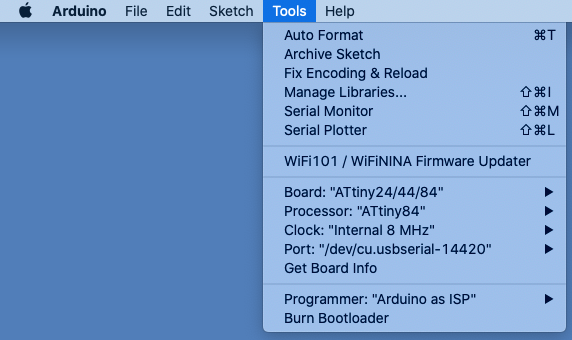

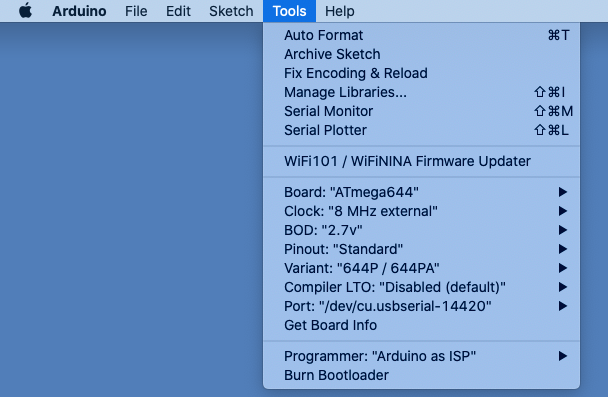

The MCU on the gateway and 3 button remote is an ATmega1284P. In order to compile software for this MCU you need to have the MightyCore board manager installed. You install this by adding "https://mcudude.github.io/MightyCore/package_MCUdude_MightyCore_index.json" to the Additional Boards Manager URLs in the Arduino Preferences.
Replace /dev/cu.usbserial-14420 with the actual port connected to the board.
The Arduino-Tiny repository contains the sources for several of my ATtiny related sketches. The sketch you're interested in is BMP280Remote. When compiling this sketch, make sure you edit the Arduino Preferences Sketchbook location to point to the Arduino-Tiny folder.
The MCU on the BMP280 remote is an ATtiny84A. In order to compile software for this MCU you need to have the damellis/attiny board manager installed. You install this by adding "https://raw.githubusercontent.com/damellis/attiny/ide-1.6.x-boards-manager/package_damellis_attiny_index.json" to the Additional Boards Manager URLs in the Arduino Preferences.

First set the ATtiny84A's fuses:
The fuse settings in the command line (see below) sets the ATtiny84A to use the internal resonator at 8MHz. These fuse settings also preserve the EEPROM from being erased whenever downloading a new sketch. Many default fuse settings don’t do this.

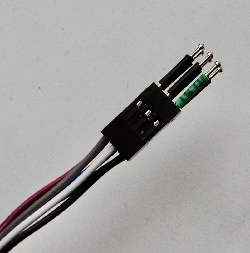

I do this using an ISP, specifically the one I designed (see AVR Programmer) You can use any AVR ISP such as Arduino as ISP built on a breadboard so long as it's 3v3. See the Arduino as ISP example from the Arduino IDE Examples menu for a DIY ISP.
Very important: You must use a 3v3 ISP or you will damage components on the board.
The following are Mac OS instructions.
Open a BBEdit worksheet (you could also do this from a Terminal window.) Note that a bootloader for the ATtiny84A should not be loaded via the Arduino IDE. All software is loaded via an ISP through the ICSP connector on the BMP280 board.
Set the SPDT switch on the BMP280 board to “OFF/PROG". This reroutes the board’s power source to the ICSP cable and disables the RFM69CW module. If the RFM69CW module isn’t disabled it will interfere with the ISP.
Connect a 6 pin ISP cable from the ICSP header on the board to the connector on a 3v3 ISP.
From within the BBEdit worksheet OR the Terminal app, run:
/Applications/Arduino\ 1.8.10.app/Contents/Java/hardware/tools/avr/bin/avrdude -C /Applications/Arduino\ 1.8.10.app/Contents/Java/hardware/tools/avr/etc/avrdude.conf -p t84 -P /dev/cu.usbserial-A603R1VD -c avrisp -b 19200 -U lfuse:w:0xe2:m -U hfuse:w:0xd7:m -U efuse:w:0xff:m
The path to your Arduino application should be used in place of "/Applications/Arduino\ 1.8.10.app".
/dev/cu.usbserial-A603R1VD above should be replaced with whatever USB serial port is connected to your ISP.

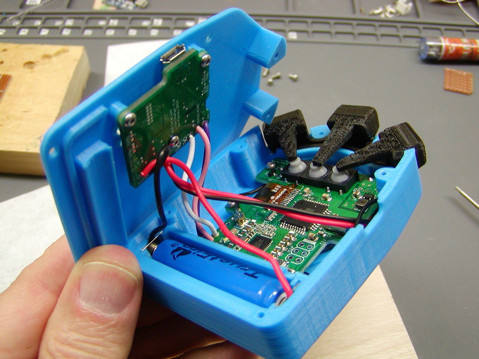

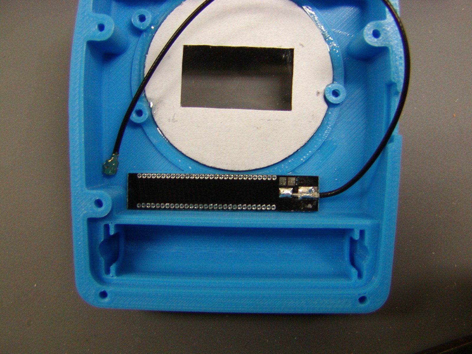

Step 12: Assemble the BMP280 Remote
The 2nd picture above, shows an alternate case design that incorporates a plug for charging. The plug simply taps into the positive and negative wires within the case. See the thingiverse link to view this and a small case to hold the inexpensive lipo charger.
Parts:
(6) M2x4mm hex socket button head screws (ISO7380) (source)
(1) 11x7x2mm Nitrile rubber (aka NBR) O-Ring (source)
~22cm 1.5 diameter rubber gasket material. (aka Rubber Jewelry Cord) (source)
(1) 28mm snap ring (source)
(1) set (+ and -) of AA/AAA battery spring plate 10x9mm plate size (source)
(1) 433MHz 40x7mm PCB antenna with IPEX connector (source)
7cm 26awg Red wire
4cm 26awg Black wire
2mm diameter acrylic rod (used as a light guide for the LED on board) (source)
(1) 10440 AAA size 600mAh 3.7V Li-ion battery (charged)

Step 13: Burn Bootloaders on Gateway and 3 Button Remote
It’s easier to burn the bootloaders before installing the boards in their cases. The gateway originally used the ATmega644PA MCU, but due to changes in the libraries the code doesn't fit, so I switched to the ATmega1284P. The 3 button remote can use either MCU. Setup the Arduino IDE following the instructions in step 10.
Connect your 3v3 ISP/Programmer and select the corresponding serial port in the Tools menu.
Select your ISP/Programmer in the Tools menu.
For each board:
With your ISP connected to the ICSP header on the board, select Burn Bootloader in the Tools menu.
If everything is connected and configured correctly you should get a success message in the sketch log pane.
This would also be a good time to set the Network and Node IDs for these boards. Follow the instructions in Step 11.

Mount the display:
Leave the protective film on the display face until final installation.
Place a strip of 6mm wide electrical tape along the upper edge of the board as shown in the photo.
Place a strip of double stick tape as shown in the photo.
Place/adhere the display to the board using the outline printed on the board as a guide.
Preparing and installing the acrylic face:
Print the attached 3ButtonRemoteFace.PDF
Carefully cut out one of the printed faces following its outline.
Spray a thin layer of spray adhesive to the cut out printed face following the spray adhesive instructions.
Remove the protective plastic film from one side of the acrylic disk.
Carefully place/adhere the printed face to the exposed side of the acrylic disk.
Mount the disk in a vise with the indentation on the edge of the printed face exposed.
Using a chainsaw file or some other fine round file, file the acrylic to match the printed indentation.
Repeat for the 2nd smaller indentation. Note that these indentations are used to align the disk, so accuracy counts.

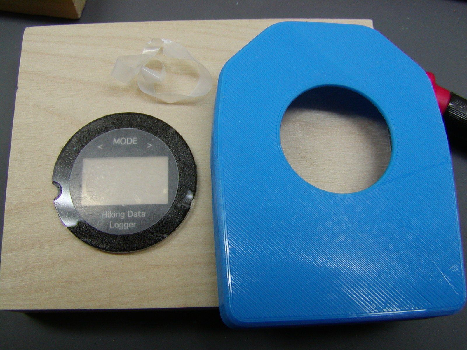

Pre-fit the disk in the base.
While holding the disk in the base, use a utility knife to scribe the 30mm base circle with just enough pressure to cut the protective plastic film and not damage the acrylic.
Remove the disk from the base and carefully remove the outer ring of plastic film created in the last step, leaving the center 30mm circle of protective plastic film in place.
Mix a small amount of plastic epoxy and trowel it on the outside ring of the acrylic disk.
Press and align the acrylic disk in the base.
Gently remove any epoxy that may have squeezed out from either side of the disk being carful not to smear any epoxy on the exposed rectangular paper window.
Apply pressure to the acrylic disk by temporarily installing the board using three M3x4mm screws and set the base aside till the epoxy cures.
Once cured carefully remove the remaining protective film. This should also remove any remaining epoxy from the acrylic face.
For each of the 4 cover holes over the USB serial charger board status LEDs, follow the instructions as described in step 12 for preparation and installation of the LED light guides.
Solder the separate Red and Black wires to the battery plates as described in step 12.
Solder the other end of the battery cables to the USB serial charger board as shown in the photos.
Solder the bonded Red/Black power cable to the main board as shown in the photos.
Solder the other end of the Red/Black power cable to the USB serial charger board as shown in the photos.
Solder the remaining 3 wires as shown in the photo between the USB serial charger board and the main board. (DTR, TXD, RXD)
Install the antenna:
Remove the protective layer on the antenna’s double stick backing.
Place the antenna in the base as shown in the photo.
Attach the IPEX connector to the main board.
Make sure the switch on the USB serial charger board is set to ON. When this switch is in the other position DTR will not reset the board as needed when uploading a sketch.
Remove the protective film on the display.
Install both the USB serial charger board and the main board using 6 M2x4mm screws.

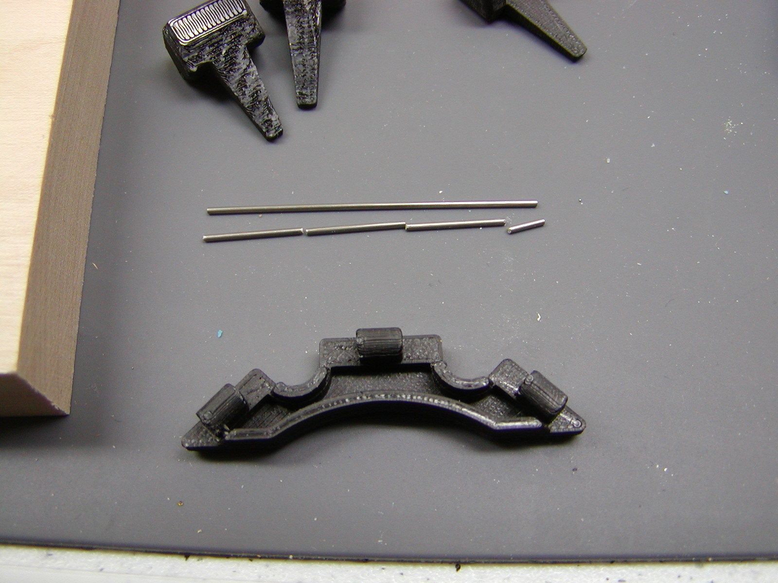

Assemble and install the buttons:
Clean up the button prints by removing the support material on the button arms.
Cut the 1mm stainless steel rod into three 15mm pieces. To cut the rod use a cutter with very hard faces. Do not use a cutter designed for copper or you’ll ruin the cutter. Only make an indentation on the rod. Using two pliers, snap the rod at the indentations.
Attach each button to the button plate using the 15mm rod pieces.
Press the button plate into the base as shown in the photos.
Slide the battery plates into the battery compartment slots as shown in the photo.
Install the battery.
Install the back cover using the remaining M2 screws. You may want to wait on this step till you successfully load the software. Getting the cover on without pinching the battery wires is kind of tricky but doable. I used tweezers to position the wires so they don’t get pinched when closing the cover. I never got around to changing the design to allow more space for these wires.

Step 16: Assemble the Gateway
Parts:
(7) M2x4mm hex socket button head screws (ISO7380)
(1) set (+ and -) of AA/AAA battery spring plate 10x9mm plate size, ~14x9 including solder tab, 9mm width
5cm 26awg Red wire
5cm 26awg Black wire
(1) 14x20mm speaker (source)
(1) 30x30mm 1mm thick acrylic square. (source)
2mm diameter acrylic rod (used as a light guide for LEDs)
(1) 10440 AAA size 3.7V Li-ion battery
(1) 2-pin Micro JST PH 2.0 connector & pins (source)
Assembly:
Note: The picture above shows board version 1.0. The latest version v1.2 uses an RTC chip. Assembly is the same for both.
Place double stick tape on the board within the outline of the display.
Cleanup the base print by removing all support material. There will be support material in all cutouts on the top wall (SD, USB and switch). There’s also support material in the speaker bracket slot on the side to the battery compartment.
Ream out the two 3mm LED holes on the base front.
Following the instructions in step 12, ream and install the four 2mm rod LED light guides on the base front.
Preparing and installing the 30x30mm acrylic face:
Pre-fit the acrylic face in the base.
While holding the acrylic face in the base, use a utility knife to scribe the outside square with just enough pressure to cut the protective plastic film and not damage the acrylic.
Remove the face from the base and carefully remove the outer strip of plastic film created in the last step, leaving the center 24x24mm square of protective plastic film in place.
Mix a small amount of plastic epoxy and trowel it on the outside edge of the acrylic face.
Press and align the acrylic face in the base.
Gently remove any epoxy that may have squeezed out from either side of the face.
Apply pressure to the acrylic face by temporarily installing the board using four M3x4mm screws and set the base aside till the epoxy cures.
Once cured carefully remove the remaining protective film from both sides. This should also remove any remaining epoxy from the acrylic face.

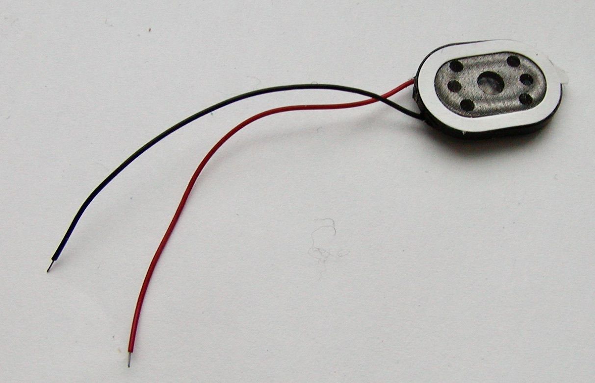

Install the 14x20mm speaker
The speaker wires can either be directly soldered to the board or you can use a micro JST PH 2.0 connector. If the connector is used, crimp the pins to the speaker wires. Insert the pins into the connector matching the polarity shown in the photo.
Remove the protective layer on the speaker’s double stick backing. Place the speaker in the base as shown in the photo.
Using one M2x4mm screw, install the speaker bracket as shown in the photo. Note that the other end of the bracket fits in a slot on the side of the battery compartment.
Solder the Red and Black wires to the battery connection on the board as shown in the photo.
Remove the remaining protective film on the acrylic face and display.
Install the board using four M2x4mm screws.

Log Mode:
Controls starting, stopping, resuming, ending a log and swapping the start and end locations.
For all states of log mode, the time, temperature and elevation are displayed on the bottom two lines. The temperature can be displayed in Celsius or Fahrenheit. The elevation can be displayed in meters or feet.
When a log isn’t in progress log mode displays the starting location in green, and the ending location in red.
When a log is in progress log mode displays the elapsed time and the percentage complete in terms of elevation gain or loss.
The left and right buttons are used to cycle through the available actions.
To select an action you press the center button, enter.

Review Hikes Mode:
Used to view up to the last 125 hike summaries.
The center button toggles the summary data displayed. The first screen displays the starting and ending locations, elevations and temperatures. The second screen displays the starting and ending time, the day of week and the hike duration. Line one of both screens lists the hike date.
The left and right buttons are used to cycle through the saved hike summaries.

Info Mode:
Displays the current time, temperature and elevation. When a log is in progress the elapsed time and percentage complete is displayed. The temperature can be displayed in Celsius or Fahrenheit. The elevation can be displayed in meters or feet.
Log Mode:
When a log isn’t in progress log mode displays the starting location and starting elevation.
When a log is in progress log mode displays the ending location and starting elevation.
The available actions are displayed on the top line of the display. Depending on the available options, pressing either the left of right button enact the command by sending the command to the gateway. The response from the gateway will cause the remote to update the display to reflect the result of the command being enacted.
