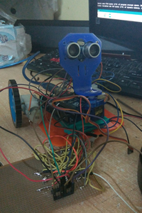

In our prototype version 1.0 .we assembled our motors wheels and built our chassis.
Also there is a LCD to display message and make HinDeR interactive.
Obstacle avoiding functionality was incorporated with the use of one ultrasonic sensor on the front mounted on a servo motor to give it a rotating neck like feature.

In V1.2 we have improvised on the looks of HinDeR.
Unlike the previous versions we have made use of 3D printed cases to enclose our 2 ultrasonic sensors .

Throughout the previous version V1.0 V1.1 and V1.2, the challenge that remained was the use of so many wires which was messy, voluminous and didn’t give the bot a tidy look.
Solution
In V1.3 we decided to structure out a humanoid robot shape.
This gave rise to our concept of humanoid bot. Choosing to build the bot on a bigger size ruled out the problem of messy and voluminous connections of wire as we could now keep the connection inside a structured body which is hidden from the outer world.
