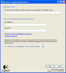

If you do not need a fancy media server then the logitech media server aka squeezebox is a good choice.You can get fancy equipment from logitech, but they are nice enough to allow you to use their software lon a server. The software I think is available for the tradiotnal platforms. We will be using linux and an old Pentium two computer.
You need two pieices of software depeding on what your system had. Our pentium II is a minimal command line headless box.Do not let the command line scare you. Once we do the install everything will be done from a web browser.
Get the squeezebox software for the 32 bit intel based computer.  (http://www.mysqueezebox.com/download)
Install the software.(you may need administrator's rights.)
Run LogitechMediaServer-7.7.3.exe
Make a directory to hold your media,
 md   c:\var\media\
Copy your media files to that folder. (It is ok to use sub-folders.)
Now to the web.
Point your browser to squeezeboxhostname using a port of 9000.
In my case:
http://typo1:9000
You will need to setup a username and password if you do not already have one.  There is a like to the site to do that.
Log in:
Then you can set things up to look at the directory you setup to hold your media.  Then just modify the settings to what you prefer.
Save them.
Add the media to the play list. It is all point and click.
S that takes care of the server side.
Now you need to go to your media player, In my case it was an Insignia infocast with third party firmware. You will go to where the squeeeze box application is.Enter in the address of your server.
In my case it is:
http://typo1:9000/stream.mp3
Spelling is critcial here.
Now just tell your squeezebox client to play. Voila you have media. In my case it was music files.being played.

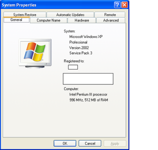

Step 2: Update, Your CPU.
Do this at your own risk. Best to let a professional do it.
It is not so true today but on the older pentium two and three computers it was very easy to swap out the Cpu's to get greater speed. I have an old Dell GX110 that had a cpu that was only 733 Megahertz. I was able to swap out the Cpu and get the speed up to 800+ megahertz. Upgrading the memory if you can is also a big help.
Note: another reason to keep old computers for spare parts.

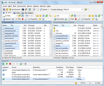

Step 3: Get to a 'nix Box.
Unix ( i.e. unix, linux, BSD, and etc.) based computer are becoming prevelent. Many linux administrators do not like use the Samba or Mocrosoft compatible protocols. With Winscp, you can get around aall that and talk to the 'nix boxes directly. In some cases you may find file transfers are a lot faster. winscp should be able to ssh into the nix boxes so you can easily do administration task.
You cqn get the software at: http://winscp.net/eng/download.php

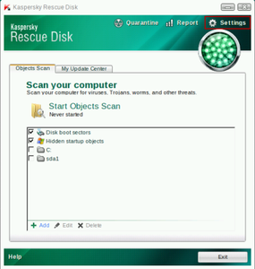

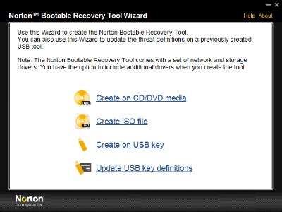

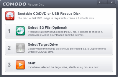

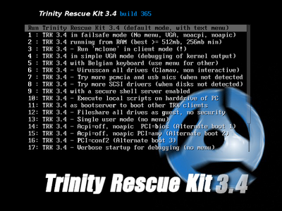

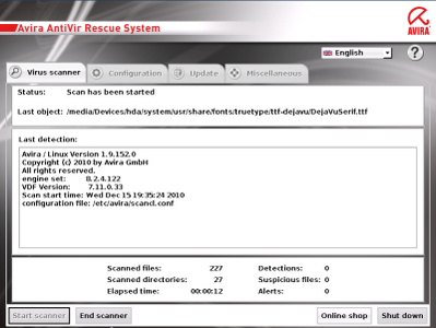

Step 4: External Antivirus Tools.
Having worked as an Microsoft administrator for many years. if you need to deal with viruses, it is better to not do it within Microsoft Windows. Viruses have become so sophisticated, Even bit defender can not always do a good job.There are so many third party products, you will wnt to try them yourself to see which one you prefer.
http://support.kaspersky.com/4162
http://download.bitdefender.com/rescue_cd/
http://security.symantec.com/nbrt/nbrt.aspx?
http://www.comodo.com/business-security/network-protection/rescue-disk.php
http://trinityhome.org/Home/blog.php?front_id=15

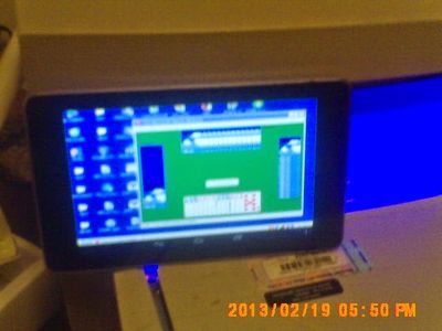

Step 12: Turn an Android Tablet Into a MSWindows Tablet.
Cheap MSWindows tablet for under $50
If you have access to MSWindows machines (XP, 7, or 8), you can build an MSWindows tablet for under $50 dollars. Purchase a cheap Android tablet for under fifty dollars and the add a free rdp (remote desktop) app from the app store and you have an instant windows desktop. Just connect to your mswindows box. If you do not have access to mswindows systems then get a cheap system for a few hundred dollars. Still cheaper than the tablet per se. You come out ahead.
