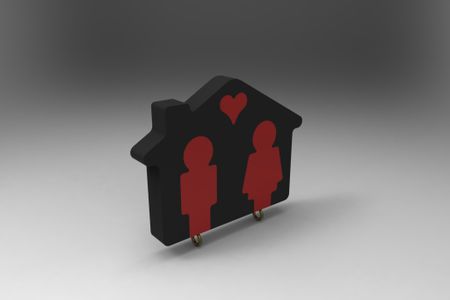

I wanted to design and make something that used the laser cutting process but was also highly functional - if you built this you could definitely use it day in, day out! This 'His and Her' Keyring is designed to be mounted on the wall whilst holding the owners housekeys. As you leave the house, you take either the male or female figure with you. When returning, the keyring is placed back into the holder - remember this and you will never forget where you put your keys!!

Step 4: CAD Renders (Optional)

Step 12: 'His and Her' Keyring Complete!
