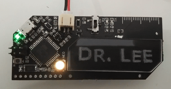

An engraved name tag with a built in micro-controller and a ruler to measure their tiny egos with.
The name tag is edge lit and shines using internally reflected light.

After the boards arrive, solder the components. They were purchased from LCSC, and are common enough to be available from most other suppliers. All the components except the battery are on the front. They can be soldered by hand with a cheap soldering iron. A pointed tip works best. If you have some steel wool handy, it helps with keeping the tip clean. Use plenty of flux. I recommend a flux pen like this one.
- First solder the microcontroller.
- Then do the USB port.
- The other ICs can be done next.
- Do the WS2812 LED
- Finally do the passives and, switches and JST connector.
Doing the hardest ones first makes soldering a more pleasant experience. Use the interactive BOM to keep track of what goes where.

Mistakes in the design
- On the top silkscreen, the ON side of the power switch is indicated incorrectly. The switch is ON when it is towards the bottom end of the badge and OFF when it is towards the top end.
- The USB connector needs to be grounded. The pcb does not do it. Solder a suitable resistor between the USB casing and a nearby GND pin.
- The VCC pin on the SPI header is not connected to anything else. This means that during programming, power must be supplied to the board through the 3v3 pin.
