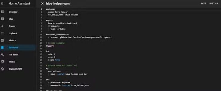

Step 3: ESPHome Setup
First you'll need to source the fonts I used for this project. They can be found here:
You'll need to place them somewhere accessible for ESPHome to use. I place them in a fonts folder under my ESPHome install on Home Assistant.
From the ESPHome submenu of Home Assistant as shown in the screenshot, create a new device. Insert the ESPHome yaml configuration making changes as needed for your own setup. With that in place you'll need to setup new secrets set in the yaml file. For my own projects I rarely use secrets here and just rely on it in the yaml but opted to do such for this public one. You'll then need to install your ESPHome firmware. In Home Assistant you can configure your ESPHome devices and choose the option to "Install".
The first time may want to run "Manual download" as you'll need to get the device programmed. My home assistant install is in another room so I usually do that as my option to make things easier. You can visit https://web.esphome.io/ in Chrome or Edge to then install this download. Connect and install your downloaded file. After this you should be able to update the device OTA without any issues.
Add the ESPHome device to your devices and using its UI configure the option to allow the device to communicate with Home Assistant.
