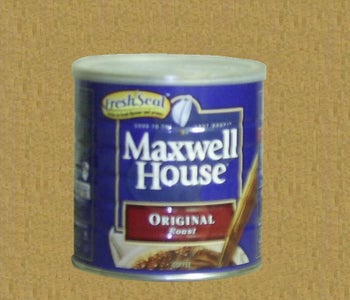

Step 1: Materials
I started with two coffee cans of the same size I retrieved from my recycling bin. Any container that is solid and has a lid can be used to make the tumbling chamber or the base. Tin or thick plastic will do best for mounting screws and bolts.

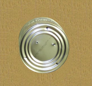

Step 2: Tumbler Chamber
One can I drilled five holes (the tumbler chamber). I saved the plastic lids of the coffee cans to use later as a protective base and as the lid of the tumbler chamber. Three of the holes I drilled ½ inch in from the outer edge to mount the suppression mounts. The two holes I drilled for the motor mounts were strategically located by placing the motor on the bottom of the tumbler chamber locating the shaft of the motor in the center of the chamber. Then I marked the hole placement with an ice pick.

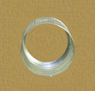

Step 3: Base
For the base I cut the bottom out of this coffee container with a can opener. Weather tin or plastic be sure the base is solid enough to support the finished product. This can be done by placing a five-pound weight on the top of the base and gently shaking, if it collapses it is not strong enough.
