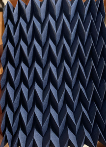

  • Miura-ori (Expandable Material)

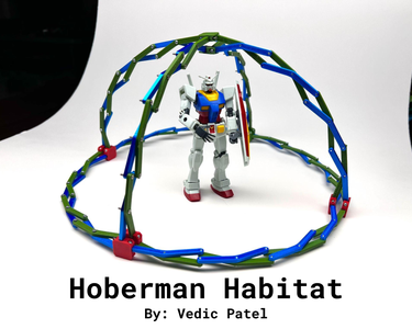

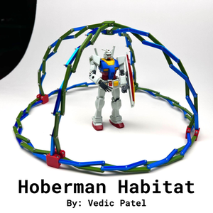

After a successful demonstration of the linkages in Fusion, I began sending the linkages to my printer. I printed my linkages and connector pieces and began assembling them to create the frame of the spheres using M2 x 4mm screws.
Step 5: Physical Model Gallery
After connecting the linkages and connector pieces, I was able to create the domes!
My physical model spans 12 inches tall, totaling 24 inches for the complete double-dome design.
