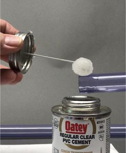

Step 6: Assemble Tubes (Water Chamber)
Test fit the PVC pieces and then glue them together. Be careful of external glue dripping down all over.
I found it was nicer to have excess glue outside the fitting rather than inside, so I applied the glue to the external surface of the tube or reducer, rather than the inside of the fitting.
Make sure to practice the alignment and the twist so you will end up with the right alignment when you mate the pieces.

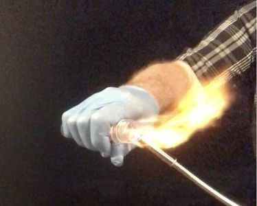

Step 13: The Proof Is in the POP!
Fill a test tube with hydrogen by holding it over the stopcock and opening the stopcock to let the hydrogen flow into the upside down test tube. (Remember Hydrogen gas is lighter than air) Stop the flow before electrolyte flows out. Cover the test tube opening with your thumb until you are ready to hold a lighted flame to the opening - POP!
Enjoy!
P.S. Note that water vapor covers the inside of the test tube after the pop. The hydrogen burned with oxygen from the atmosphere to create water.
Note: For some reason I am getting lots of Hydrogen and very little oxygen gas. I have swapped the electrical polarity (thinking it might be something wrong with one of the electrodes) and still have very little oxygen generated. Any thoughts would be appreciated.
WARNING: Mixing two parts hydrogen with one part oxygen is a gas referred to as Brown's gas. It is used for torches, internal combustion engines, etc. Do not mix the hydrogen and oxygen in this way unless you have a properly protected explosion proof setup, as Brown's gas is explosive.
