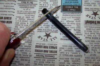

Step 3: Cut a Waterman Down in Size
Cut about 3/8 inch (10 mm) from the back end of a Waterman cartridge. Before cutting I used an eyedropper with a piece of hobby tubing glued into its end to remove the ink in the cartridge. See my earlier Instructable: https://www.instructables.com/id/Refill_Your_Fountain_Pen_Cartridges_and_Save/
