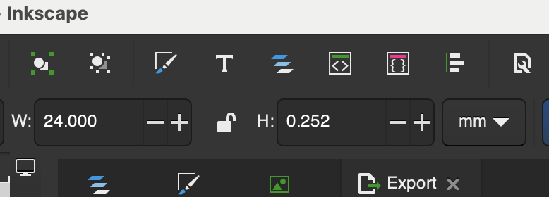

Step 1: Prepare the Design in Inkscape
Option A – Make your own design:
  1. Download and open Inkscape
  2. Use the Pen tool to draw the sides of the box in line segments (this is an easy way to trace the friction-fit edges)
  3. Tip: Hold Ctrl to create straight lines, and use copy/paste to save time
  4. Adjust dimensions using the toolbar at the top of Inkscape as pictured above
  5. Connect the lines to form the 2D drawing of the sides of your box
  6. For the top design, download a simple Lex brick graphic
  7. Import the image into an empty Inkscape file and using the Trace Bitmap tool, select Detection mode of the edge detection tool, and apply it to the image - this will provide a clearer, graphic image to work with
  8. Use the Node tool to clean up excess nodes - an image of the nodes is shown above
  9. Tip: Fewer nodes = faster engraving
  10. Export your completed SVG files

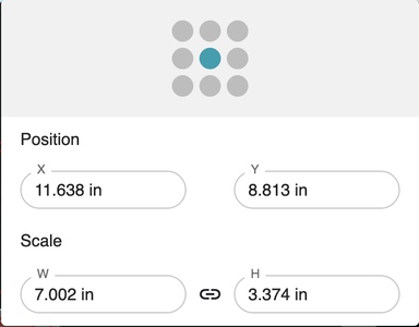

  6. Use the Glowforge tools to arrange the designs on the wood
  7. Place the Lex brick engraving on top of the top piece outline and adjust the sizing
  8. Tip: If scaling doesn’t work, make sure to unlock proportions in Glowforge as shown above
  9. Check the cut order → engrave first, then cut pieces
  10. Press print on Glowforge, wait for the light to glow, and push the button start your job
