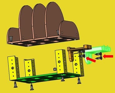

I designed a holder with a space for an 8 port USB charging unit under the holder for the device.
The outer dimension of the holder is 135mm x 116 mm.
The inner dimension is smaller because the corners are 16 x 16 mm. That results in an inner area of the 8 Port charger 103 x 84 mm and a height of 50mm
Cable holder size: 135 x 150mm
Cable holder extension size: 135 x 90 mm
When they will be connected together the size is 135 x (150 + 90)mm
Many USB cables with different device plugs are located around the charging place and also the mobile devices are at this place. This design helps you to have an overview about the cables. While charging the mobile devices can be fixed into one of the 4 slots. A holder for an Apple watch is integrated as well as a holder for a Garmin Watch Forerunner 55.
The cables are hanging at a cable holder to have an overview about the different plug types and to find at once the cable you want to use.
The exploded drawing shows how you have to put the parts together.
Use 12 x wood screw M2 x 10mm with flat heads to connect the parts

After the printing of the parts you have to mount the parts together like 3d puzzle.
Step 2: Connect the Device Holder Lower Part and the 4 Corners With the Screws
The corners have wholes with a diameter 2mm. So use the screws that will fit into the wholes.
(M2 x 10mm) or (M2 x 12mm)

Step 3: Connect the 4 Corners and Device Holder for IPad With the Screws
Now you have the main unit. You can use it without mounting the additional parts for the watches.
Step 4: Mount the Devices for the Watches at the Side Area of the Corners
