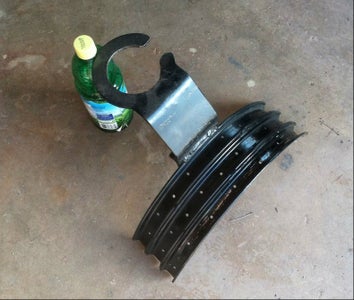

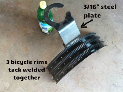

1 - Wide Bicycle Rim cut into 3 pieces
1 - Piece of flat steel plate approximately 12" x 6".
TOOLS:
Cardboard or poster board & masking tape to make pattern for top piece
Acetylene/oxygen cutting torch to cut the flat plate
Grinder to smooth up cuts making the top piece from flat plate
Metal Brake or acetylene/oxygen heating torch to bend flat plate
Chop saw, metal saw or hand held air cutting tool to cut rim.
MIG welder to weld the 4 parts together
Paint

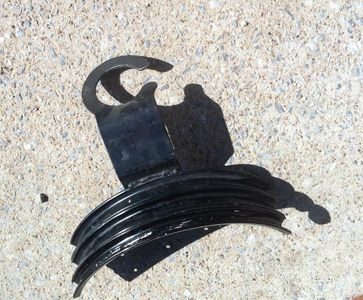

Step 2: Decisions....Decisions
I originally made this using 2 pieces of a bicycle rim welded to a top piece made from 3/16" flat steel plate. When placing the big wire feed lead on one rim piece and the ground on the other, it was too crowded. I decided it would be better if I had 3 pieced of rim. This proved to be a better option.

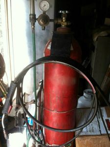

Step 3: Installed on Top of Bottle
This slips on and off of the bottle neck quickly and easily. It is easy to wrap the leads around when storing, and take them off when preparing to weld.
