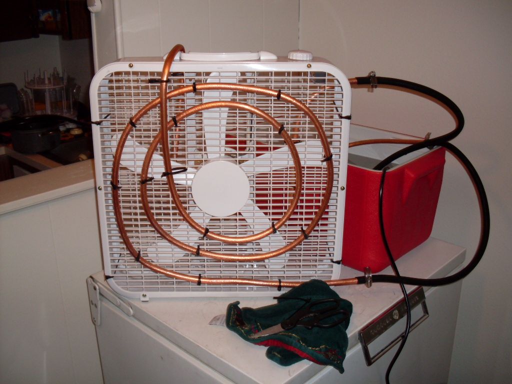

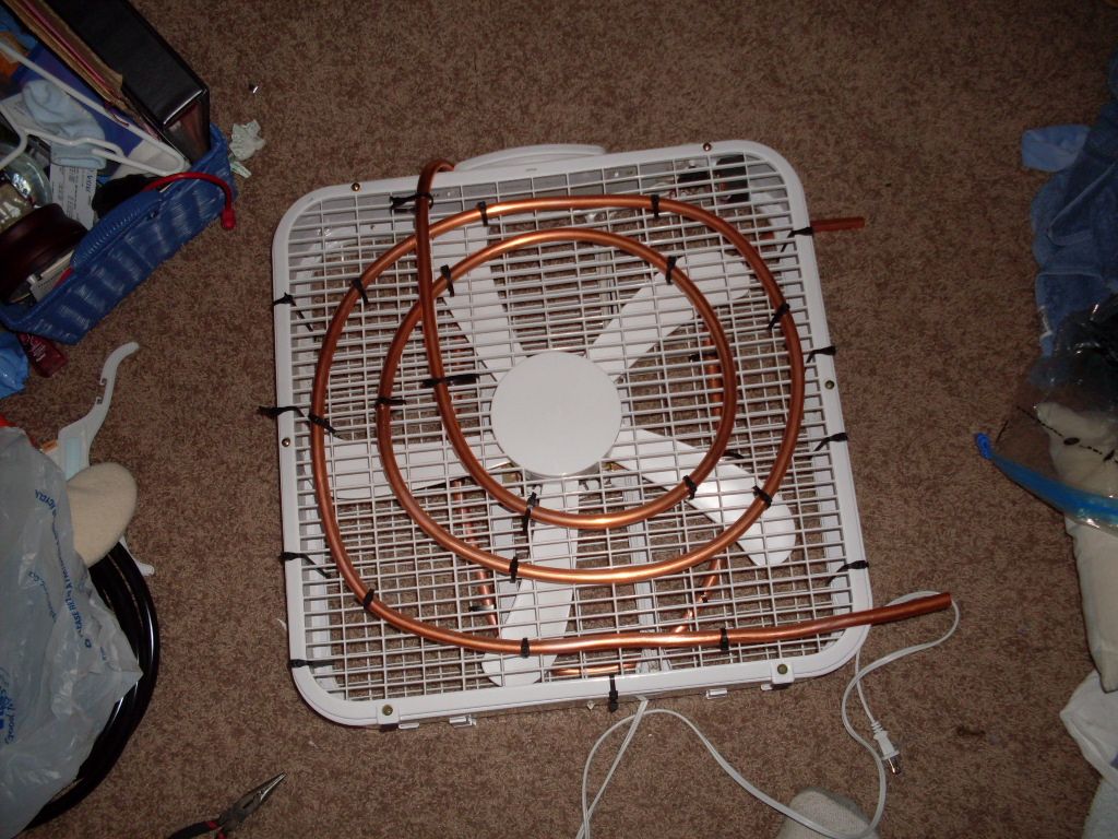

take the fan. turn it to where it sits front-up. Start coiling the copper around the fan.
place a zip tie every 6" of copper. Once finished coiling, attach vinyl tube to feed end of copper.

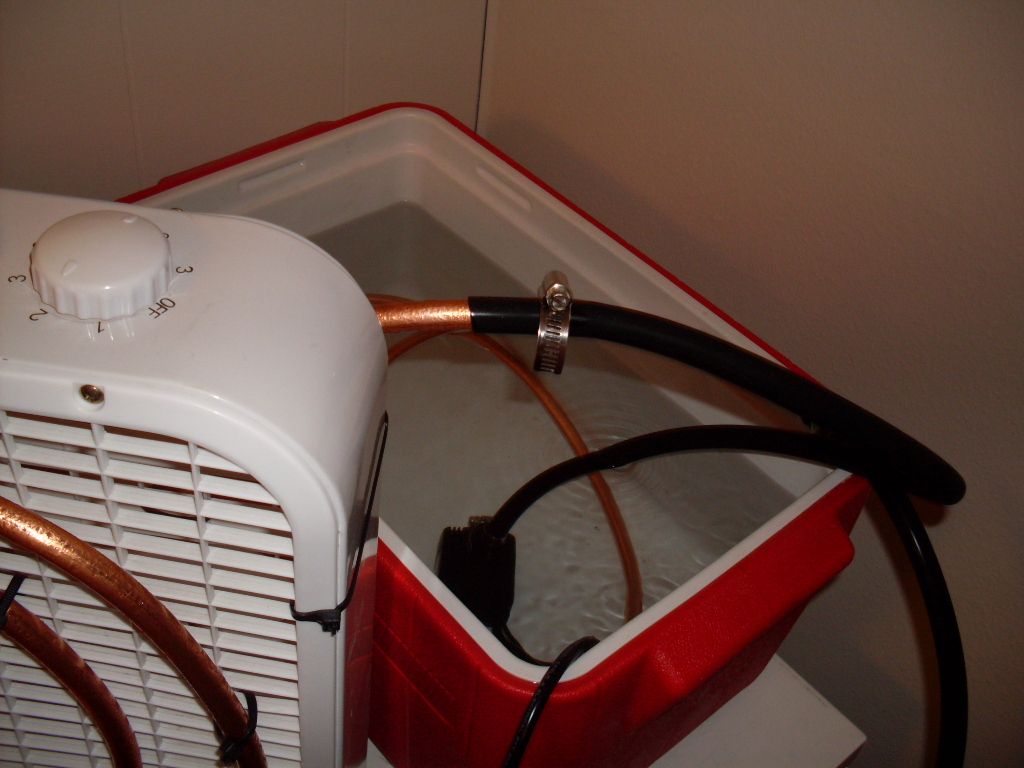

Then, lead the tube to the pump. Connect it. then, cut the tube in half. Clamp the remaining half of tube to the return line, and lead it back into the cooler. Use the hose clamps to clamp down the connection between the copper and the vinyl tubing.
Step 3: Step Three: Enjoy It.
Fill the cooler up with water, and plug in the pump. Let it run for 3 minutes, to get the coil cold, and then turn on the fan. Enjoy your new cold stream of air! I have made mods in the updates step.

4. I also added some safety labels, pic 3.

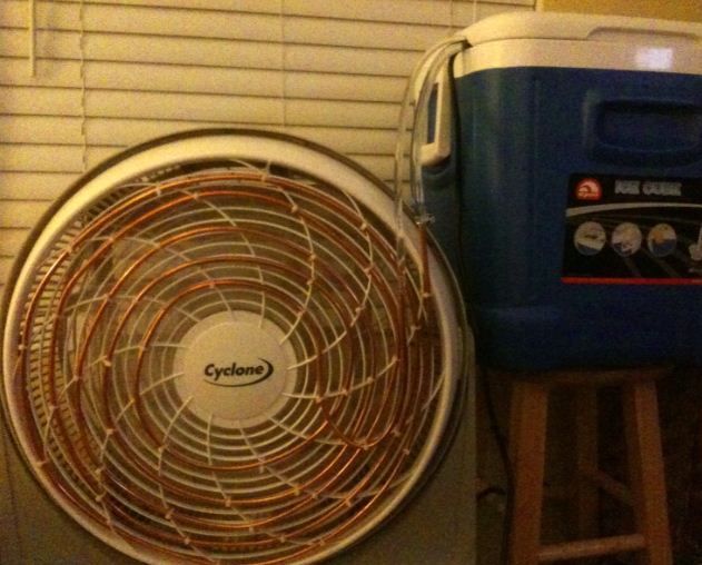

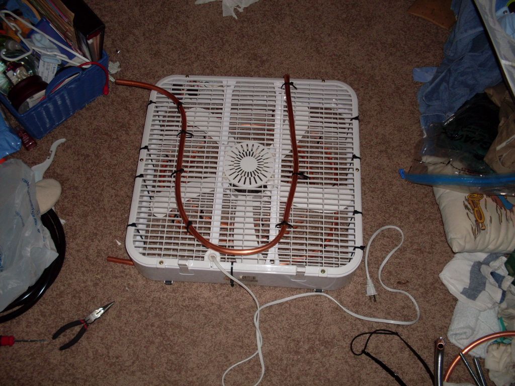

Hey, just to let you know, I threw this together in a couple hours yesterday afternoon during the heat and oh man! It RULES for being a quick and cheap alternative to buying a portable AC unit for my apartment. I've got pictures if you ever want to see how I did it.
Reply 14 years ago on Introduction
thanks. I would like to see the pics. please post them ASAP
Attached are the images, I did things a bit differently, but it seems to work just fine.
what size is your copper tubing, and how much did u use? Did you test it with another a/c on, or by itself in a hot room?

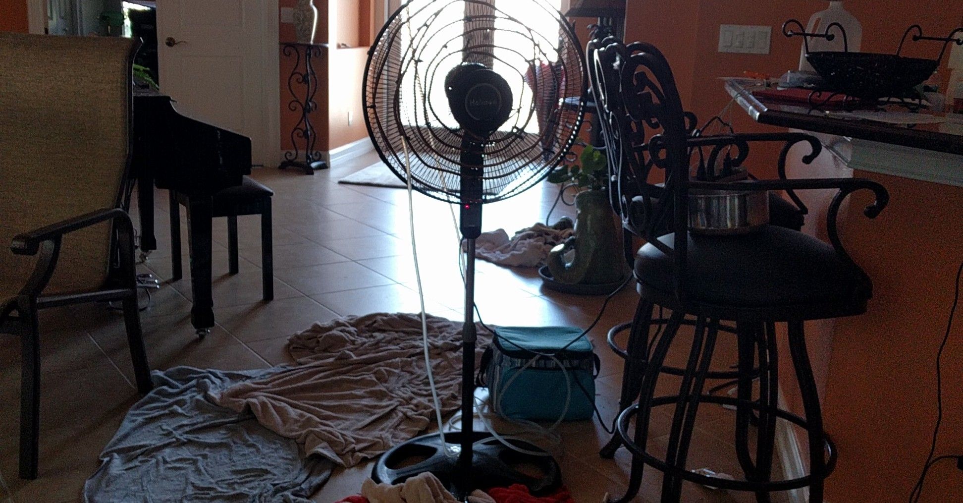

Tested building two versions of this today since it was freaking NINETY-FIVE today and went thru 40 pounds of ice in only 4 hours. I was using an older foam cooler which leaked thru the pores but my radiator setup did a GREAT job of delivering the cold.
