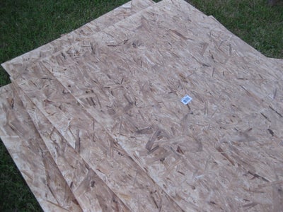

Step 2: Cutting the Letters

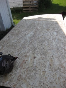

All of the letters were cut 16" for the main legs of the letters with a 9" x 16" triangle cut at the exterior corners and a 3" x 5-3/16" triangle for the internal corners. The second Picture shows the measurements for cutting the O's. The H and L's are pretty simple to figure out. The D is an O with two corners not cut. The Y and W are just cut to look good I will measure and let everyone know what measurements I used.
I used a circular saw and jigsaw to cut all letters. Just make sure you have support under the entire letter the OSB board likes to bend during cutting.

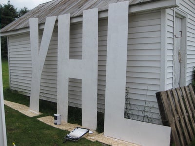

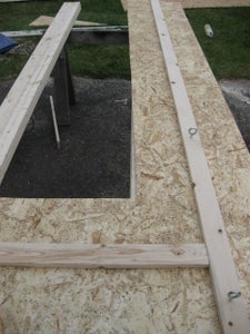

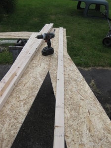

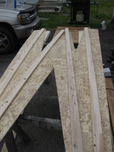

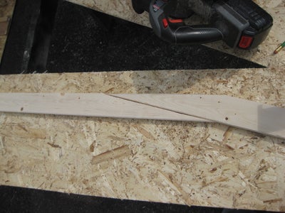

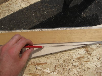

Step 3: Frame Support

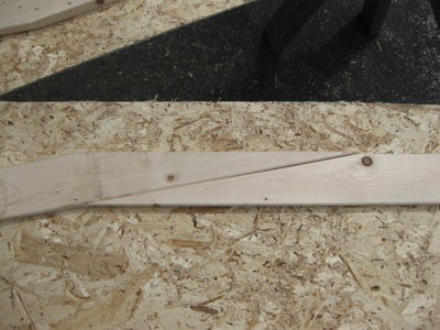

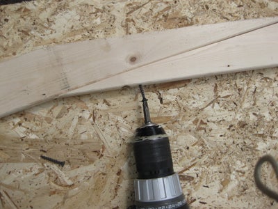

Use the 1"x2" strips to support the letters. The strips are attached to the back of the letter with the wood screws from the front of the letter. Make sure you always have two support strips perpendicular to the ground for the rebar supports. Pre-drilling the supports makes the attachment much easier. For the Y I cut the support strips to match the angles. Marking the angles is easiest with a straight edge or carpenters square. Place the straight edge on top of the support strip in the orientation you want the board, mark and cut. I kept the straight edge even with the edge of the OSB board to ensure the proper angle. The W uses all straight boards no need to cut angles.

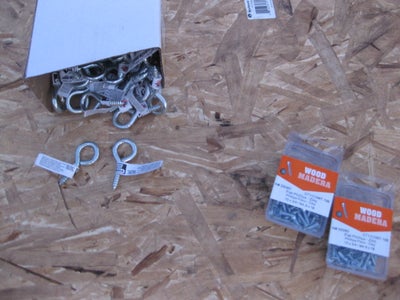

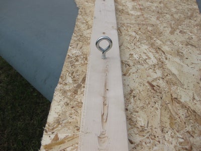

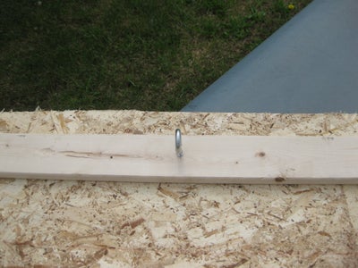

Step 4: Mounting Harware for Standing
Use 4 screw eyes on the back of each letter (only 3 needed for each of the L's) to make a slot for the re-bar to fit into. The screw eyes are able to slide onto the re-bar after it has been driven into the ground to help the letters stand. This also makes it easy to take the sign down in case of bad weather or high winds.

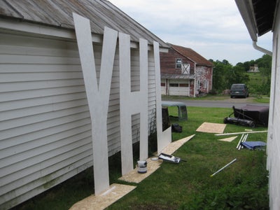

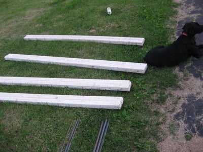

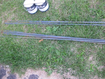

Step 5: Standing Support Rods

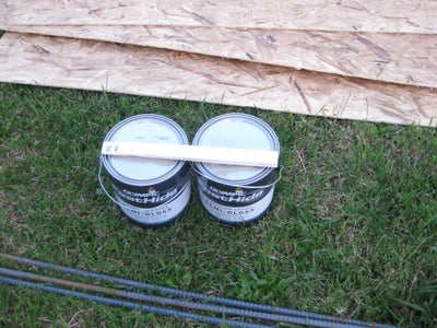

You need 16 sections of long re-bar, and 2 short (for the L's)
Step 6: Paint
White Semi-Gloss Paint worked well with two coats.

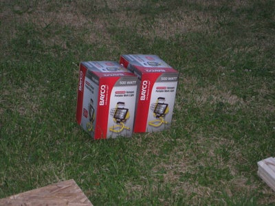

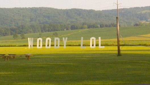

Step 7: Lights!
4 - 500w work lights worked very well to light the sign at night.

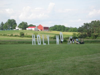

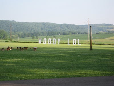

Step 9: Action!
And every night the letters would mysteriously move themselves.......
