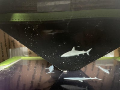

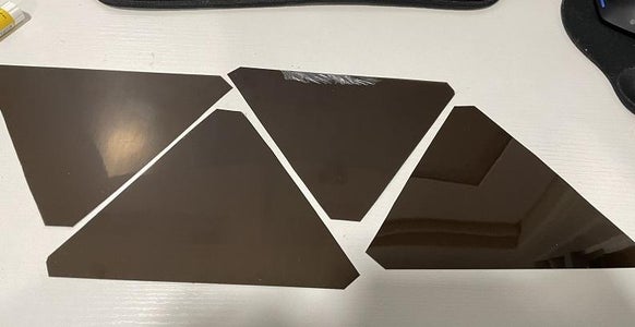

Step 1: An Unsatisfactory Result
My first attempt used a dark plastic sheet to build a hologram pyramid. It helped, but wasn't satisfactory. The dark sheet was less transparent and harder to see through
In my, second attempt, we built a dark box, trying to balance the better reflection ability with the reduced light coming into the box and the loss of transparency. We used different kinds of boxes and found out that the easiest way is to use a box that can flip the top open. A shoebox is perfect!

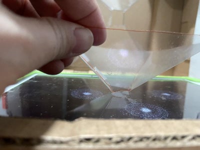

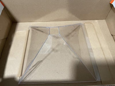

Step 2: Hologram Pyramid

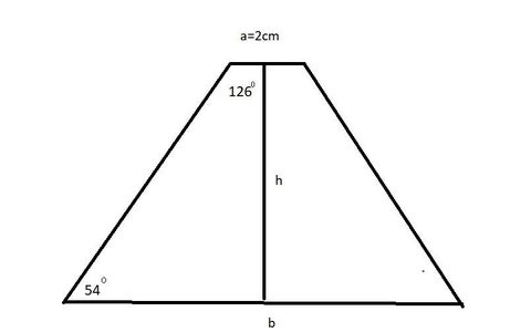

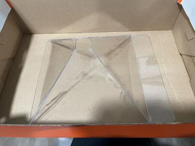

For each side of the trapezoid shape, make sure the top side (short one of the parallel sides of the trapezoid) is 2cm (if you're using a tablet), or 1cm (for most phones). The size of each trapezoid should be such that the final pyramid can fit into your box AND the small end is appropriate for the device you are using. As long as the angles of the trapezoid are as shown in the template, you can adjust the size of the trapezoid accordingly.
In addition, note the height of your pyramid. Measure the thickness of your device (say iPad) as N cm. Measure the depth of the box as H cm. Your pyramid should not be taller than (H-N) cm.

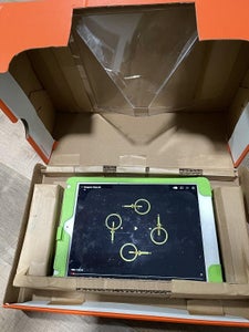

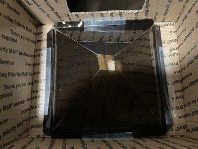

Cut out the trapezoid. Tape the sides to form a pyramid. Once the pyramid is made, tape it on to the bottom of the shoe box as shown. I used brown masking tape, so it's a bit hard to see.

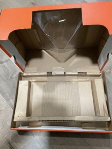

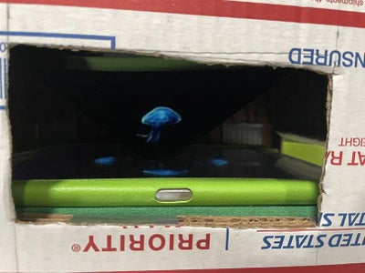

Step 3: Make Observation Window.

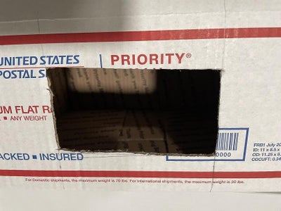

Cut open a window in the middle of the long side of the shoe box. My observation window is 6”x2.5”. Yours can be different, but you should be able to see most of the side of your pyramid.

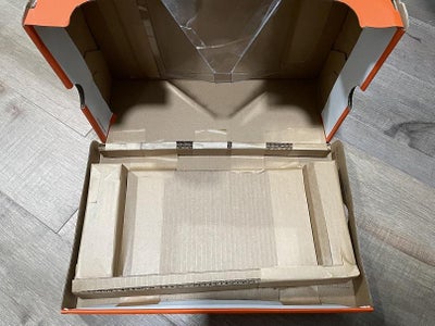

Step 4: Secure the Device's Height

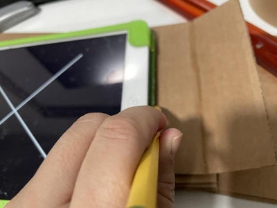

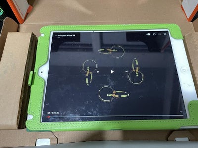

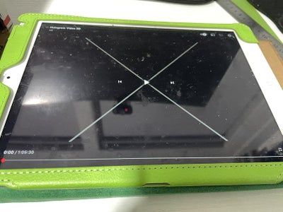

The device/tablet will fit into the shoebox’s lid. We need to pad the lid so that when the box is closed, the 2cmx2cm opening on the pyramid will align with the center of the tablet video display. You can find the center of the display by loading any of the hologram videos on YouTube (https://www.youtube.com/watch?v=Y60mfBvXCj8 for example). It will display as a big white cross at the beginning of each video. The cross is the center we need to align with the opening of the pyramid.

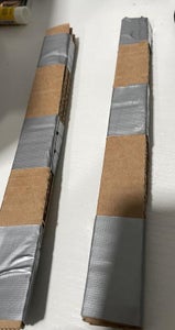

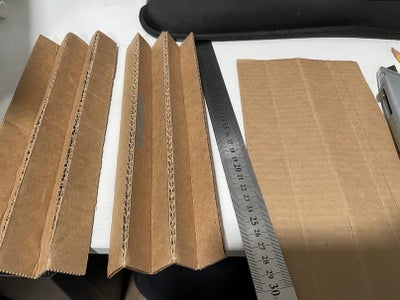

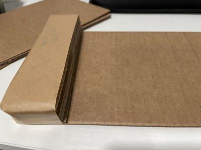

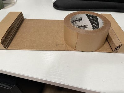

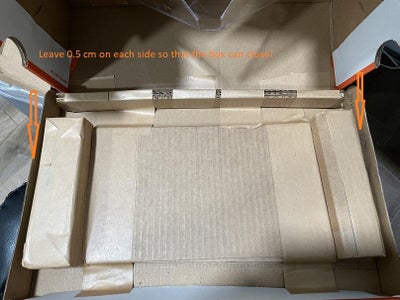

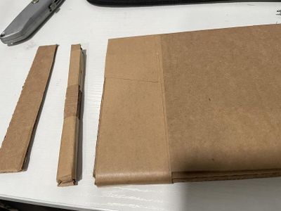

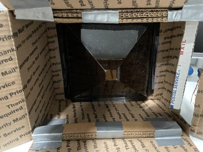

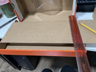

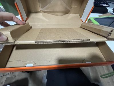

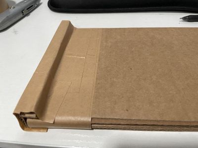

First adjust the height. Cut cardboard of length 1 cm less than the width of the shoebox lid as shown. This 1cm space is for the edge of shoe box bottom to fit in so the box can be closed. When you glue the padding to the shoebox lid, leave 0.5 cm on each side. Add layers of cardboard so that when shoebox is closed, the screen of the tablet lightly touches the opening of the pyramid. Secure layered cardboard to the shoebox lid.

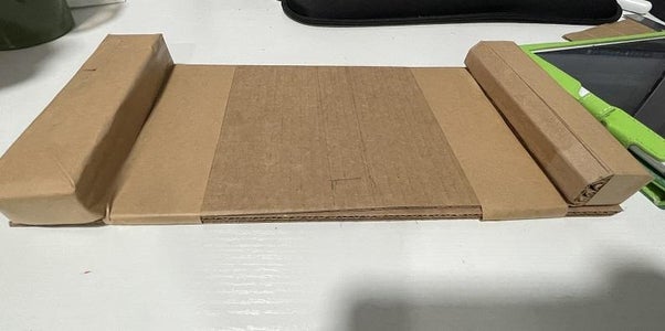

Step 5: Secure the Device's Length

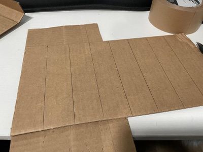

Add padding on both sides so that the device’s display center aligns the center of the pyramid, opening along the long side of the shoebox lid.
Step 6: ...And the Width
Same process as last step, just along a different dimension.

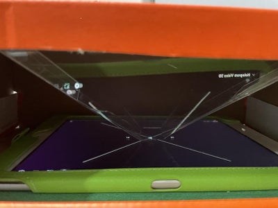

Step 7: Test the Effect.

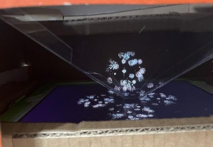

Now, fit in the device and test it by playing a hologram video (try https://www.youtube.com/watch?v=Y60mfBvXCj8).

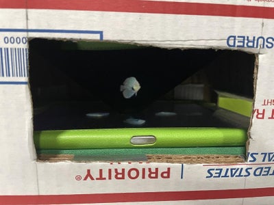

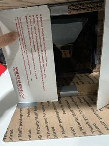

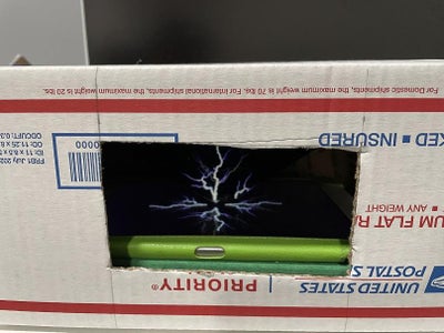

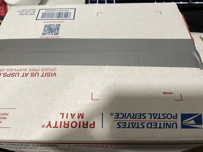

Step 9: In Case You Do Not Have a Flip-Open Box…

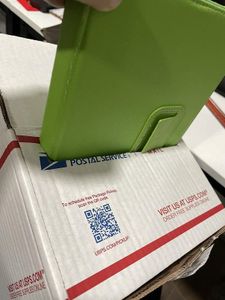

You can still do this with a regular (free!) shipping box. I made one with USPS priority shipping box 11.25” x 8.75” x 6” before using the flip-top shoe box.

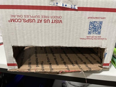

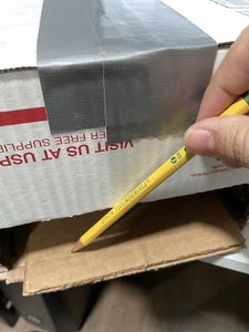

We want to cut various openings first. We first cut open an observation window on the long side of the box, then cut an opening to slide in the device.
Then, just follow the steps for securing the device and making/securing the hologram.
