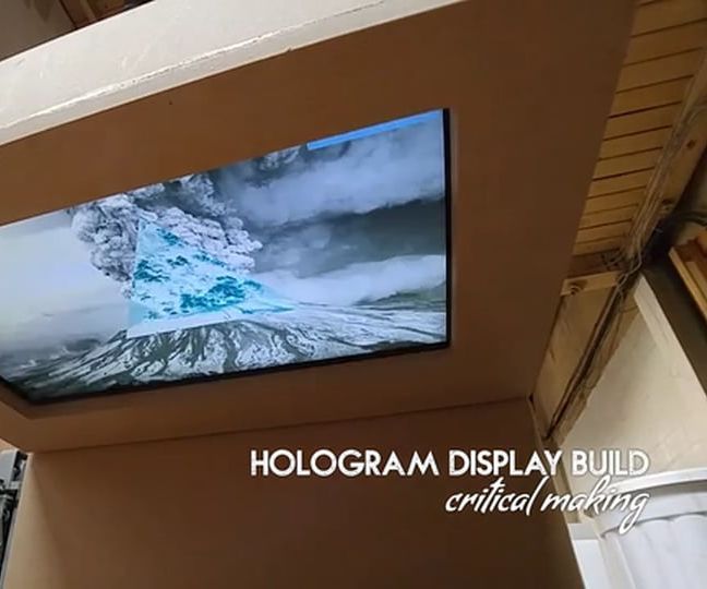

Step 7: Content / Video Projection - Object Allignment
This step illustrates the process of generating the content. It started most of the placement of the elements was done in an full screen Photoshop canvas. moving the elements and images around to properly fit them within the projection surface and the center piece.
Step 8: Content / Video Projection - Slides
This images illustrate the actual view of the source screen. In order to have it properly projected, the source monitor was displaying images mirrored. The placement of the monitor had also to be specific, the top had to be closer to the back of the display and the bottom closer to the viewer. This would allow the projection to show "normal" to the viewers but was a challenge when generating the content.
All slides and video was created using Adobe Premier for video editing, Adobe Photoshop for image editing and MS Powerpoint to generate a presentation.
Step 9: Hologram Effect Projection
These are some images of the final projection. Words and floating elements and videos placed on a black background work the best when interacting with the object.
For presentation purposes this has worked great. Please refer to the initial video to see the full content of the projection. This is still an ongoing project and a 3rd part is still to come with the proper electronics and better resolution of content.
