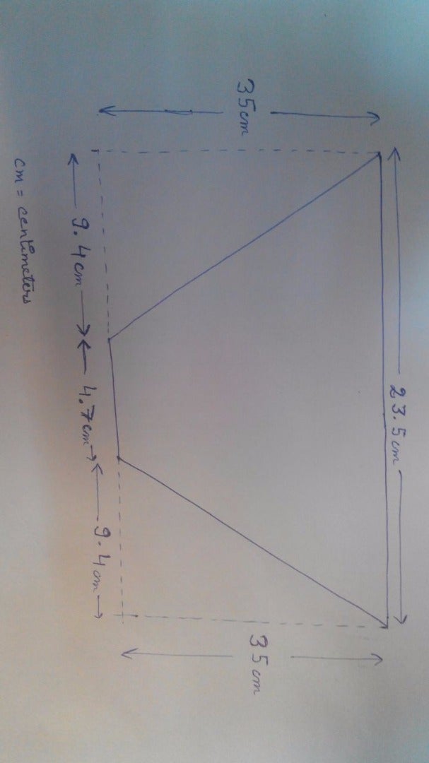

1. PRISM – Take a 4mm whole glass and cut it into 4 equal pieces according to the measurements given in the photo. Stick the glasses pieces with fevi-glue or M-seal.

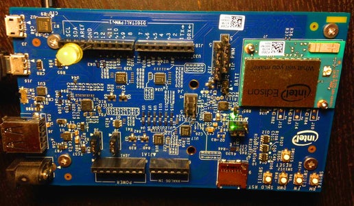

2. BOARD - Take out your INTEL expansion board and screw it (4 white screws) at the bottom for it to stand. Now attach the Edison board on it with the help of two small screws.
3. SENSORS – Now get started with your Edison board and interface your LDR sensor with it. Attach the ARDUINO SHIELD on the board. Connect the LDR sensor with an LED with the help of connecting wires and a resistance.
